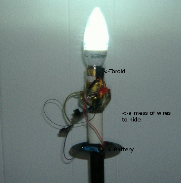

            • Hi everybody,
              I made a lamp using a tor-23 which is about 5/8 inch.
              TIP3055RadioShack
              5T,8T,84T MK1Jeanna style
              120r fixed
              309v
              40Kh
              I managed to keep the volts DOWN to 309v at 40Khz and placed the jtc between the base of the bulb and the lamp switch.
              When I did this with 700 v yesterday the switch continued to arc and never turned off.
              So, it is bright but not as bright as with 700v, but now I need to hide the wires.
              Here is my pic for today.
              To a bright and shining New Year!
              jeanna
