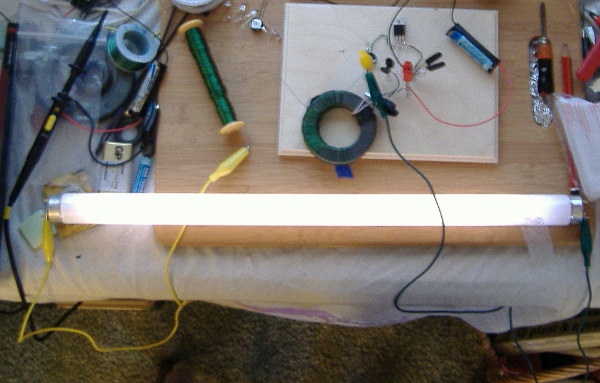

    • Toroids: J type notsogood, W type terrific
      Hi everybody,
      I finished my test on the J type material I received as a sample from the toroid people.
      I posted a small pic at ou and if you want to see the pic and some comments, here is the link.
      If you are busy today don't bother.
      I will not be using this type and the pic on overunity.com is for documentation only.
      big flakey fight to light the 2 1/2" toroid J type material.

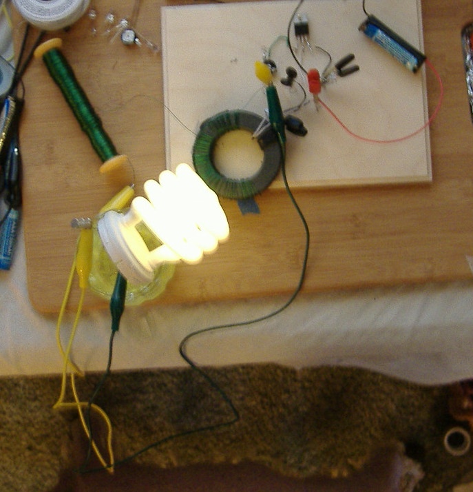

      I used the 2 1/2 inch toroid from the same folks but with the W core like the jeanna's light and it works fine.
      I will post a pic, and here is the page on ou
      the W type pix
      Here is the info
      2T,8T,100T
      TIP31C
      236r
      835v465Hz ...very low!
      It lights the 15w growlight tube and the 20w cfl easily and well.
      Here are the pix.
      I am going to wind this like the Golden one and see how it does with so many turns.
      100T is very few, so I am pleased at this progress. I just want to push it hard and see.
      here are the pix.
      jeanna
      oops I forgot to measure amps draw, and when I remembered the AAA rechargeable was too low.
      I don't have one charged up right now, and just popped in the Li AAA and OMG it showed 1200v (with the same 100 turns!)
      The amps draw with that lithium is 160mA. I think I will recharge and try again with the NiMH.

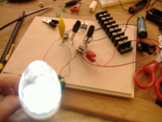

                        So, for that reason and because not everybody here likes to thrash it out at ou (or whatever) I am announcing my latest success.
                        I wound a toroid with the MK1jeanna hybrid type winding with about 110 Turns on the secondary and got 600v-727v.
                        What is so great to me about this is how small the toroid is... 0.86 inch OD.
                        the windings are
                        2T,9T,110T
                        TIP31 from RS
                        25r at the base
                        one AAA battery.
                        It lights a neon
                        a 7w fl tube
                        a 15w tube
                        it dimly lights a fat 20w fl tube but it stays lit when my hands are off it.
                        No cfl.
                        So, I had just suggested to lidmotor to take his apart and gut it for the easiest bright light (which is true)
                        I grabbed an unmodified 19leds bulb and it lights at full brightness. wow.
                        This is more light than the cfl even though the cfl is harder to light.
                        So here is a christmas present to all.
                        jeanna
