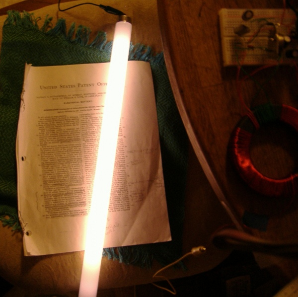

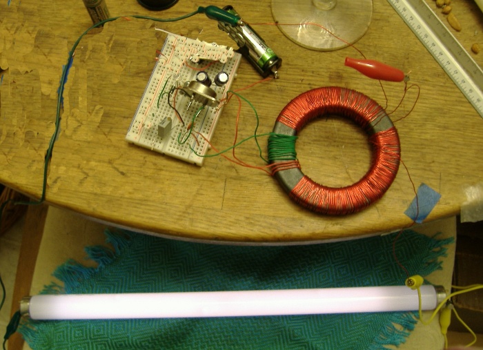

I need to correct the numbers.
13T on the base, 3T on the collector and 240T on the secondary.
I took 2 pics tonight to show it here.
1- I rubber stamped the second toroid and its transistor from the scene, so that is why all the blotchiness is on the left side of the circuit.
2- this is supposed to show the light.
It is not a lot but you can see how you could read this patent.
Please note that there is plenty of room for more turns and you might want to try for more. This is a MK1 design and it needed to be that number.
I discovered the other day that this is not true, I could add many more turns.
The essential part is that you want to have over 450v.
To start this I need to add a magnet to one side while touching the opposite side and then slide my hand toward the magnet.
Once the bulb is lit, I am free to remove the magnet.
Also, do not bother with a little transistor.
2N3055 is the pick here.have

I got the big 3 1/4" toroid core in the mail and immediately built the light circuit. It works!!
I built the toroid coil a little different: 3T base 24ga. 13T collector 24ga. 300T secondary 30ga. and I added a fouth coil 10T 24ga. just to play with (not attached to anything).
I used the circuit that you described and tried different caps, FL tubes, and voltages. All I can say is that ---it's all good! That big toroid lets you do lots of things. Its like having a great big church bell that rings well.
Jonny Davro is using this toroid idea in a SEC circuit (see Jonny's latest video) so I had to try that also and THAT worked. I replaced the L1 coil in the SEC circuit with the 3T coil on the BIG BOY toroid and it drove the SEC great. All those other windings on the toroid you could do with as you pleased. You can light up a bunches of leds on AV plugs easily.
