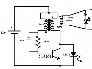

What you must have is the end of one wire connect to the beginning of the other.
It is a center tapped primary, and it is often the case that it is off center.
But for your first one, just do it and see.
Hi Jeanna
I'm not sure what you mean by the quote above. I have the start of my 3T and the end on 13T primaries going to positive the end of the 3T going to base w/resistor and start of my 13T going to collector. I assume thats correct because its working.
My circuit ran all night a total of 14.5 hours on the C cell. The light faded quite a bit but battery voltage was still running at just over .5 volts. I unhooked it and the battery is starting to come back some. My draw was around .180 so about .25 watts. I had an extra C cell so now I have a fwbr and cap hooked up and trying to recharge run down C cell.
Hi Jeanna
