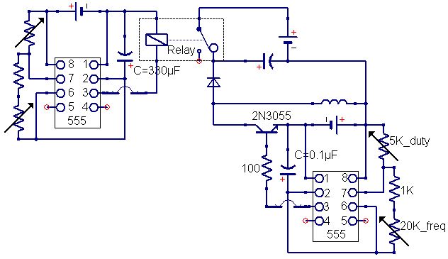

    This circuit purposes is to charge battery using capacitor charge at frequency as high as possible.
    This is based loosely from Tom Bearden design in
    20* Bedini
    There is also explanation of capacitive discharge in Thomas Henry Moray book "Beyond the lightrays". It explain that if discharging is done at spesific frequency it would add up to previous charging and increase the output.
    My short observation result is:
    - It would charge the battery very good but it seems it charge normal electricity. Charging performance is better than Tesla switch, better than Joule thief, better than Imhotep RO.
    - The transistor would not get hot if 12V source used to charge 12V battery.
    - Input current increase proportionally with load / charged part.
    - Capacitor voltage is at 11.12V when the charging battery is at 11.08V, source is 11.16V.

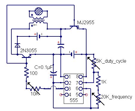

    Both transistor in the circuit should not turn on at the same time. When 2N3055 turned on the capacitor will be charged. When MJ2955 turned on the capacitor will charge the battery. In theory the battery would only draw current from the capacitor, but in reality it also draw current from the source too.
    Maybe what I did is charging the battery directly with source electricity. Maybe the transistor is not capable of switching fast enough and make it just flowing normal electricity at lower amp. The capacitor aid it a little. Any comment?
    Edit: circuit diagram fixed

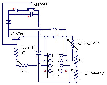

    Second version of the circuit charge a lot slower but seems to work as expected? voltage of the charged battery is increasing with very little input amp draw at 0.01A.

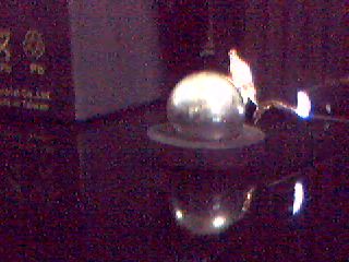

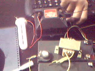

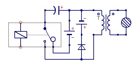

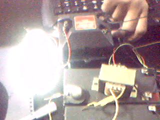

    Second circuit can also be used to ligth up CFL with the help of car coil. It can output a decent high voltage at secondary part. It also produce long spark as can be seen in this video:
    YouTube - Capacitor discharge CFL lighter

    I think relay is the way to go, transistors are not absolutely galvanically separated and not as abruptly switching. Also i believe optimization can
    be very tedious but needed, trying out many different frequency, capacity combinations.
    There is coils in relays however, so that would defy your thread title.
      Each has it's own draw back I guess. Relay contact sparking is hard to avoid and relay won't reach high frequency. My attempt is to replicate what Moray said about capacitor can have more energy when charge-discharge at very high frequency. I can't build a high frequency switching at the moment, this is why I use transistor.
      Moray did his device with transistor. I think we should be able to find a way to make OU device with transistor.
      If we can make spark free and high frequency mechanical switch, maybe we can have much much better efficiency. Still waiting for the news from Inquorate which currently trying to build it. Maybe with rotary switch inside oil bath.
      Attached is my plan to make a more efficient charger using a coil. It failed. But it would allow the charging part to have higher voltage than source. The only difference from charge battery with cap circuit is I switching the cap charging. Who knows it can make the battery charge better.
      I am thinking of charging the battery using capacitor voltage only, so the charging must be done when there is kickback voltage. This must be done at high frequency since the kickback is short lived and normal electricity will flow to the battery after that.

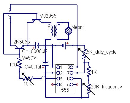

              I decide to do another coil powered by capacitor circuit. This time I use NPN to switch the coil and PNP to switch the capacitor input. I use 1Amp transformer for coil, and strangely the neon bulb in secondary light up brighter than it ever was, more over it light up only one electrode, indicating the current passing the secondary coil is a DC current.
              YouTube - Capacitor discharge charger
              The bad thing in this circuit is the input current increase proportionally with recovery part load. Maybe doing this using mechanical switch is better.

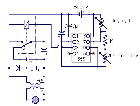

                  When relay switch is at Normally Close position, the capacitor will be charged. After relay is on and relay switch go to Normally Open position, the capacitor stopped charging and change to discharging. It will discharge to the coil. when the relay is shut off and relay switch go to Normally close position, the current collapse in coil will produce radiant spike that is either being utilized by neon at secondary or charging the battery.
                  I am thinking that capacitor reduce current in coil and coil will have spike voltage higher than capacitor.
                  I done building the relay circuit. It draw 0.04A. Charging rate is very slow, maybe because I put neon in the secondary. Currently flashing at 4 Hz. The neon light up decently bright.

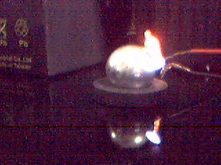

                  Using car coil, this circuit can also light up CFL. Although maybe this is because the spark in relay contact make way for the source battery to power the coil.

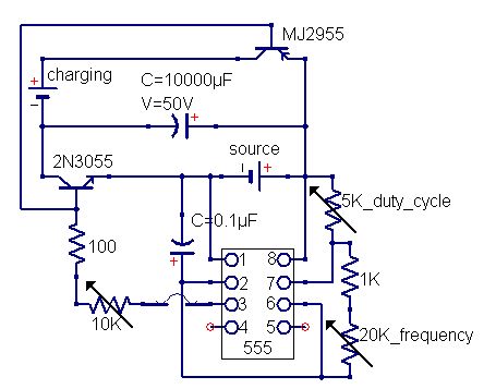

                    Using two separate timer
                    My effort so far has been dissapointing. Either the battery charge very slowly or the transistor get hot very fast. And I get different result when I change the transistor to the same brand.

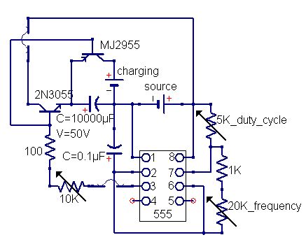

                    I decide to use different timer. The coil induction timer is in kilo Hertz range which is dumped to a capacitor. The capacitor charge is then dumped to a battery in maybe in every 2 second to give time for the capacitor to collect voltage. Since induction voltage usually higher than source voltage, the capacitor can reach 48Volts (I use 10000μF 50V).
                    I already build the circuit and will see if the charge in the battery is real or not.

                    The charging seems to have real amp. Measured by amp meter, the battery amp do increase. No self charging fenomena noticed.
                    Test report:
                    before turn off:
                    battery = 11.03V
                    capacitor = 12.5V average
                    source = 11.5V
                    after turning off
                    battery = 10.83V
                    capacitor = 10.87V
                    after half hour
                    battery = 10.55V
                    I will measure the amp tomorrow to let the battery settle down the voltage.

                          Result of the latest circuit:
                          battery = 10.03V, 4.5 Amp (previously 8.9V 3Amp)
                          I guess this circuit work.
                          Since transistor mostly interact with capacitor, it remain cooler than dumping to battery directly. Because the capacitor store higher voltage than source, charging is faster and have higher charging voltage. The part that get hot is resistor and transformer. I cant do anything to transformer, but replacing the resistor with 2watt version solve resistor heating problem.
                          The best past of this circuit is I will know wether the circuit running or not because the transformer is whistling. Little too loud though, I have to reduce the frequency a little.

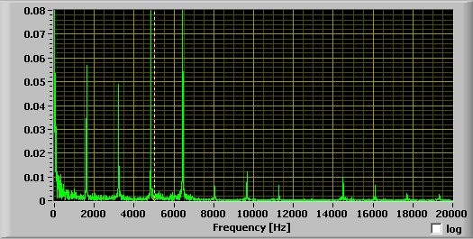

                          I attach the FFT of the circuit using car coil
