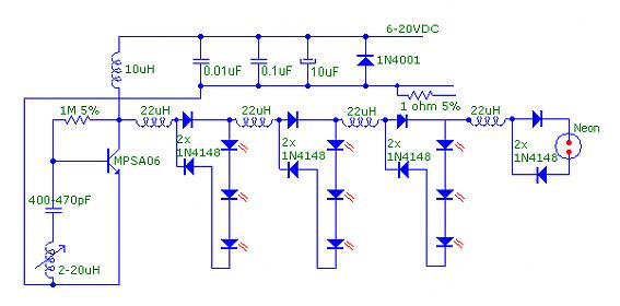

  • I did tune up my setup. I'm using variable capacitor for fine tuning. And I observed very interesting things. I don't need 2 diodes to light up neon, neon lights up with only one leg connected. Also I can light up 12V incandescent bulb at full brightness with just one end connected.
    Did anybody try to run 2 gates simultaneously? How do they affect each other? It would be my next project.

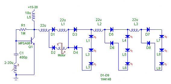

      The two circuits included are of a SEC15-20, one is the common one with four AV Plugs, the last three each power three LED's
      The second circuit in addition powers a 12V muffin fan along with the LED's
      Enjoy....

                        I've got mine MPSA06 here The Electronic Goldmine.
                        I bought 100 of Motorola and 100 of Fairchild. All of them are working fine, didn't have problems with any of transistors.
                        Also for tune-ups I'm using this variable capacitor 6 to 74pF Adjustable Trimmer Cap-The Electronic Goldmine in parallel with C1.
                        I had same problem as you describing but it is easily fixed by adjusting C1.
                        P.S. C1 I'm using is ~640 pF (470pF + 100pF + 74pF (var cap) ). My Lb Adjustable Slug Tuned Coil (Pkg of 4)-The Electronic Goldmine (using it without any modifications.)
                        Some more links of what I'm using with schema: NE2 Lamp w/ 22K Resistor (Pkg of 5)-The Electronic Goldmine, Small Incandescent Lamps-The Electronic Goldmine,Electronic Surprise Box-The Electronic Goldmine (tons of stuff you might need realy cheap), SALE! Giant 100 Piece LED Assortment-The Electronic Goldmine (not the best LEDs, but price is good), 1N4148 Glass Diode (Pkg of 100)-The Electronic Goldmine
