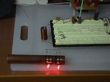

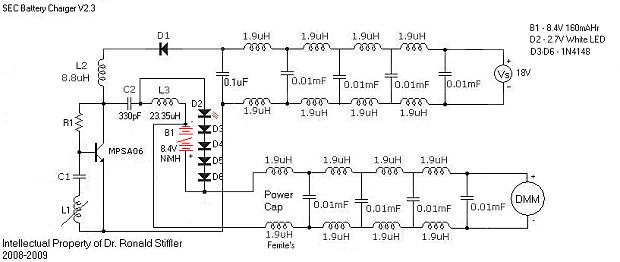

@All you need to understand batteries and charge and discharge rates for this. I make no claim here, it hold promise, yet needs work. It will charge the indicated battery in less than 20 minutes, but all is not what it seems.
You just may solve a problem here if you look into it. But you must track charge and discharge energy over a controlled period and controlled rates.
