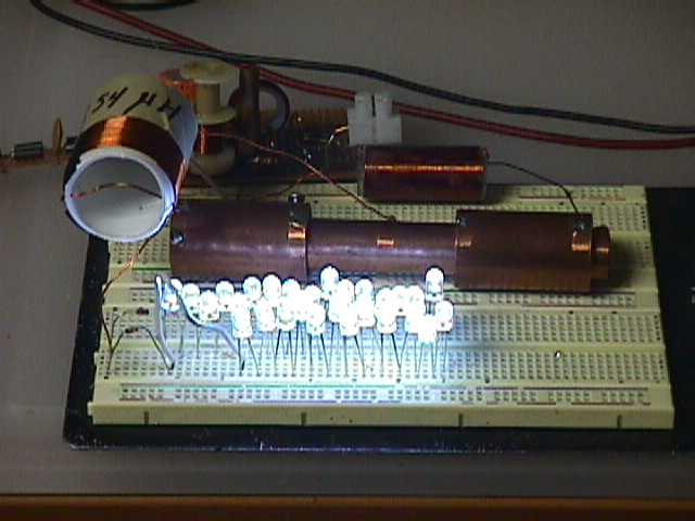

@ Mutten---- Thanks. You are right. Now that I at least got the FL to light I can go forward. I think that you were right about my L1 being too big. I'll wrap a smaller one and see what happens. I have to go "Back to the future" now and also try to get the SGate to work right.
@Dr. Stiffler----I am going over and over your videos and messages to put the pieces all together. Everytime I get something to work I go back and look at your appropriate video or text to see if I missed something. Not having a background in EE may or may not work against me here-- but I am learning this anyway. This is truly amazing stuff. I will try to replicate your "popcorn ball" experiment if I can.

I do have 2 spheres and top one is connected to the L3 (60 turns) coil. Lb tried 1uH, 2.2uH, 4.7uH (can get exciter going with all this values, but not with "popcorn") and C1 from 0 to 680pF. Tried to run it with 13-16V, no luck. So any hints or tips on tuning up would be appreciated.
