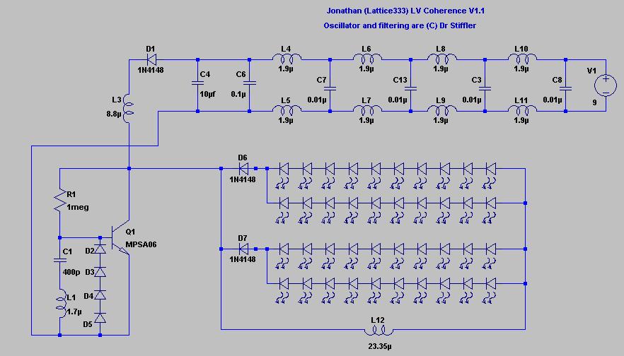

    @Dr Stiffler
    The LV Coherence V1.1 circuit attached appears to consume less power.
    I did as you suggested with 1 ohm resistor (inserted between filter and negative on PSU). The scope shots are taken just off optimal freq (LEDs are off) and on optimal freq (LED's are bright but camera exaggerates).

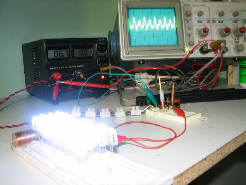

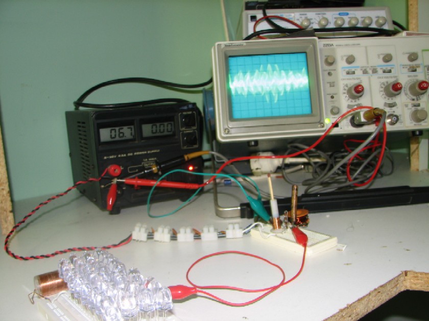

      Collector to middle inner tube, ground coil to the left outer tube. AV plugs to right outer tube.
      After some tuning I got to this first result. It is not correctly tuned, as it consumes 1,2W.
      The two AV plugs each 15 LEDs are blinding bright at max intensity, and my Weller temperature controlled solder station
      flashes its led randomly instead of the regular blink frequency indicating correct temperature.
      The temperature regulation does not work so the solder iron overheats.
      Then I turn off the exciter, the solder station resumes normal operation after having cooled down for half a minute.
      In addition the small 12V/4W incandescent lamp are connected between the outer tubes, but no glow seen.
      All connections to the tubes are via IC socket pins soldered to copper tape.
      I have 2 neos permanently mounted in the sockets soldered to the outer tubes to ease tuning indication.

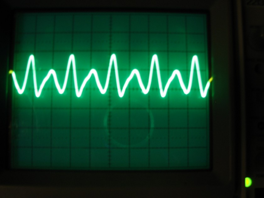

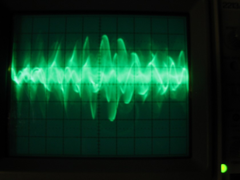

      The 3 pictures attached shows the replication, the display of the power supply and the scope shot.
      Upper trace is the base signal, the lower is the signal from the right outer tube measured by my 1000:1 high voltage probe,
      so the peak-peak value is approx. 160V.
      Just for tuning I can remove the scope probes an just place the HV probe 1cm from the right outer tune, then it pick up the signal anyway.
      I have had consumption down to 0,8W shortly, and shortly after the picture taken I got stable 1.2W.
      It can be seen from the "sine" that the tuning is not bulls eye, there are a higher frequency overlaid.
