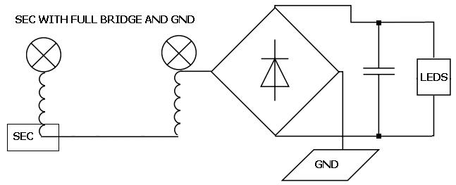

        • Dear All, Lidmotor
          A friend from Russia sent me attached picture and it has single wire combination with FULL BRIDGE Rectifier AND GROUND for SEC. He claims that this combination better than AV plug..
          Best Regards,
          Love & Brothership
          NT, TR

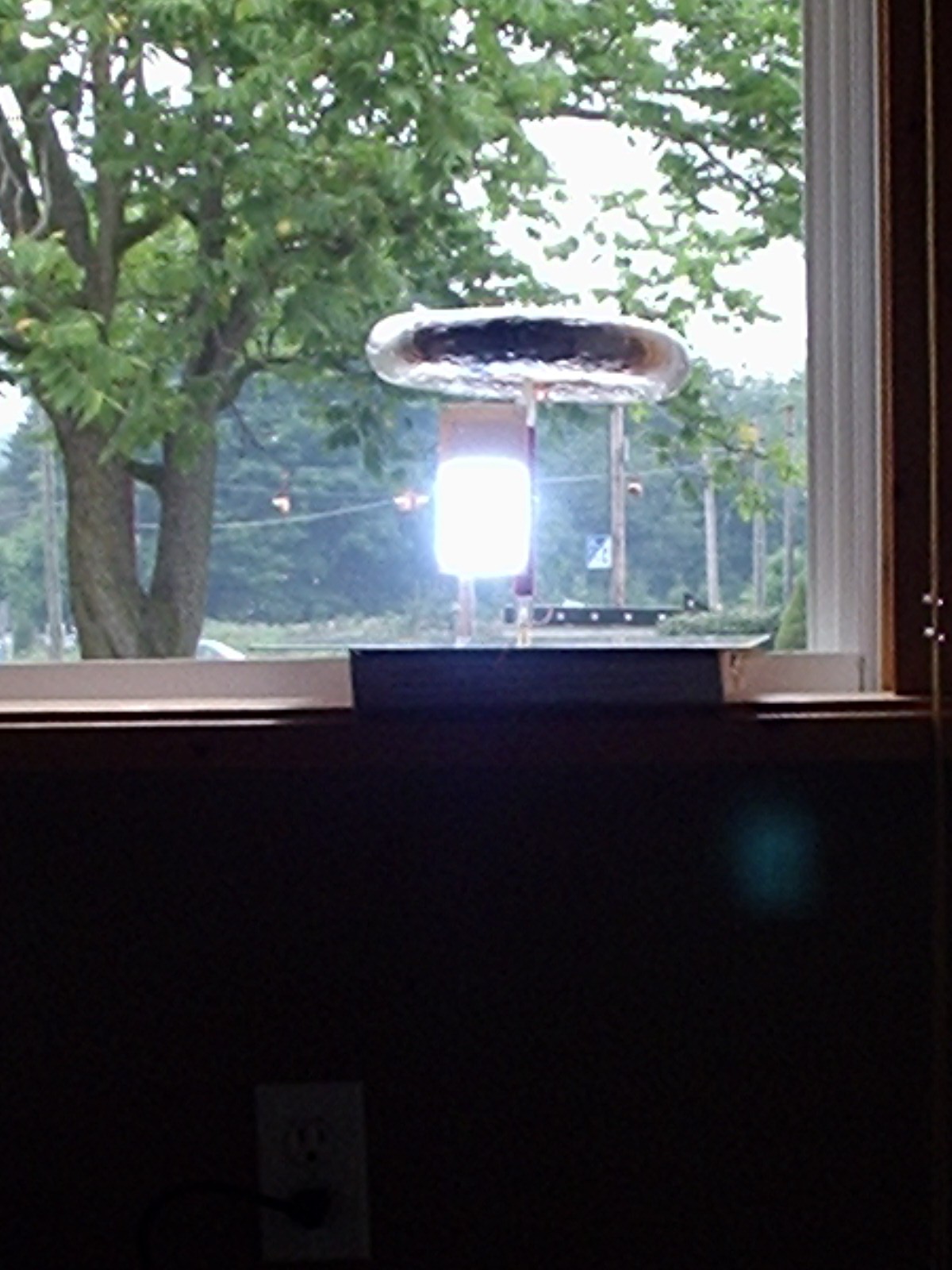

                    • Look at this light!
                      All,
                      Here is a shot of 48 LED's contrasting against August sunshine in the window behind. When I hit the "spot" in tuning they almost blinded me. This is my latest rig and it needs some additional tweaking but it is making some SERIOUS light.
                      Best regards,
                      Jim
