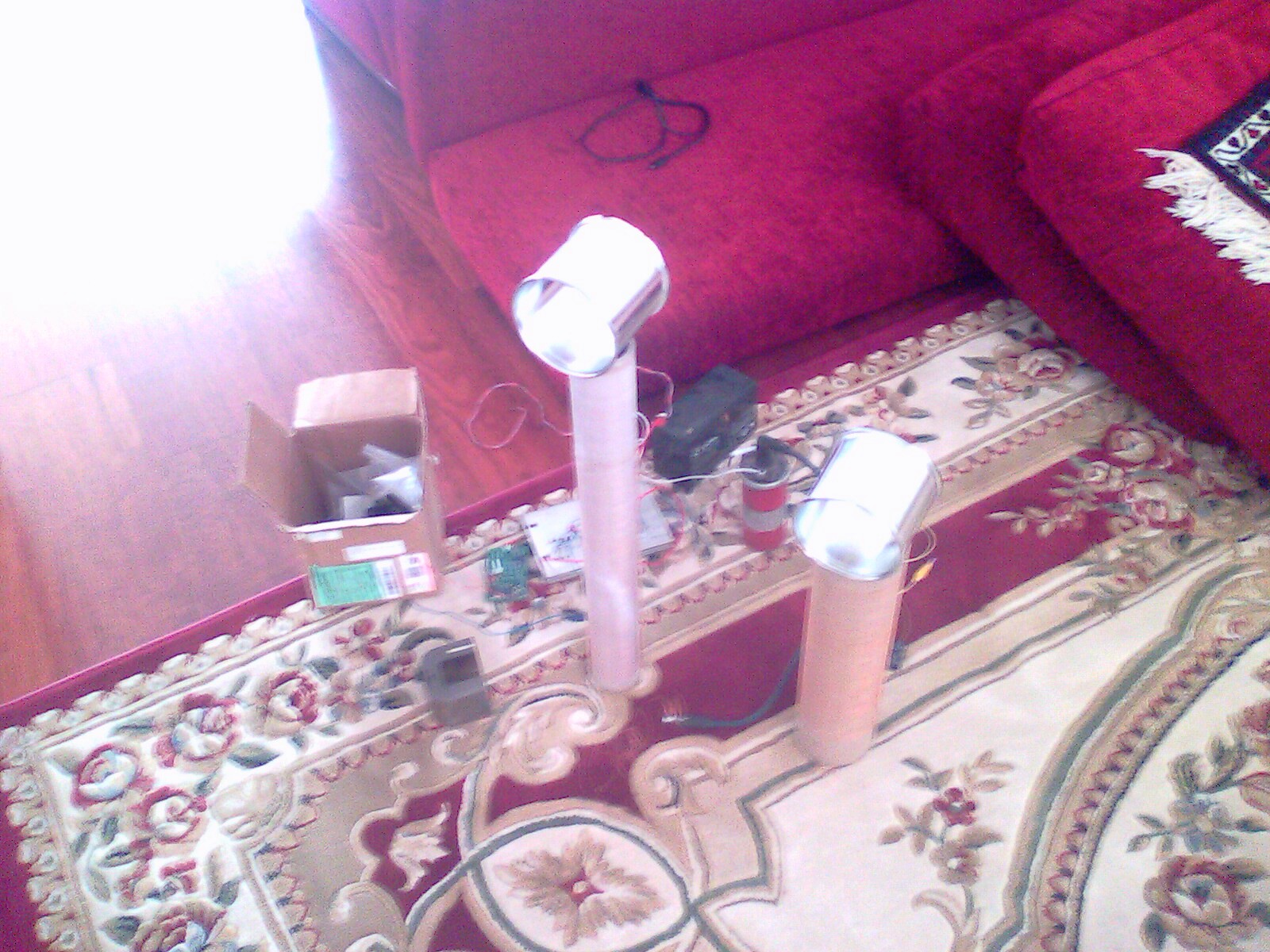

    @ all. I finally found some "condiment" cups for my towers here in Australia.
    I tried to match them as closely as possible. Sorry if I missed it before, but does someone have measurements of the Walmart ones? I assume they are stainless?
    A pic of mine below, aluminum pudding dishes. Sourced from a commercial catering shop. The bottom diameter is 45mm and the top is 65mm. It stands 55mm high. They had some other sizes there, these ones are the smallest. My only way to gauge them so far has been from sight, I approximated them from Dr Stifflers photo on the Scribd doc, the one where I can only assume its his hand holding one of the cups. Of course my gauging the cups this way relies on the assumption that the good Dr doesnt have tiny/huge thumbs!

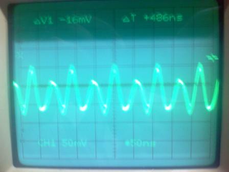

                • Dear ALL,
                  Pictures @ 24 V 15 mA..
                  This power level is quite low.. I have not tried self run mode yet..

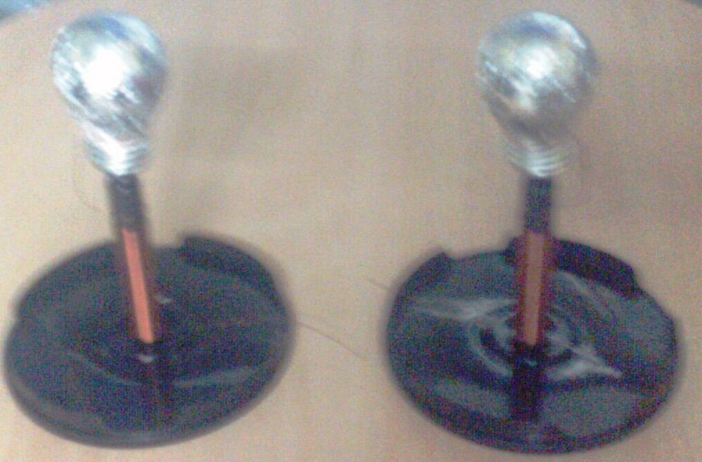

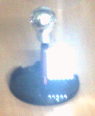

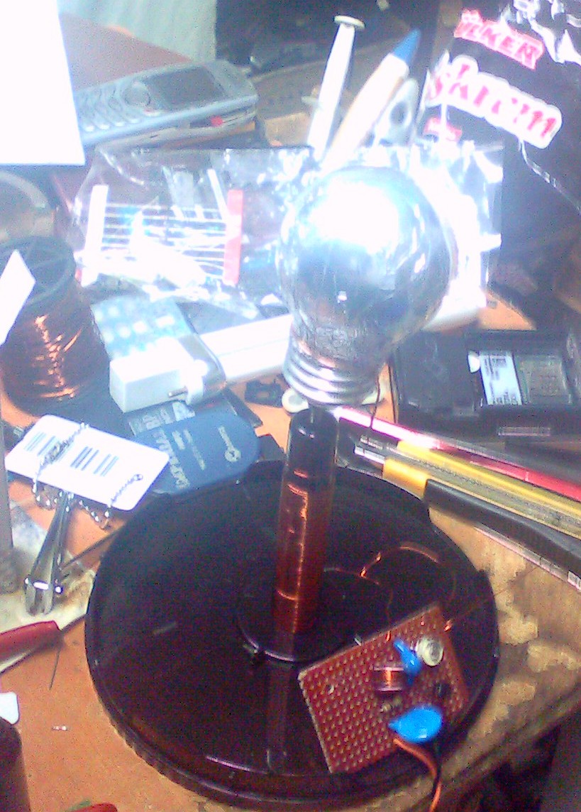

                        Dear Doctor,
                        These lamps are small circular lamps, its very common.. On the bottom of lamp there is screw and it is soldered on it.
                        I have also utilized empty CD rom boxes as base and tower structure.. They are about 1TL = 0.75 USD each..
                        I have not tested range but it was 6-7 meters...
                        I can connect to common ground of university lab and go to another building and connect receiver to GND if you like...
                        I have burned MPSA06's you have sent me before.
                        I ve used Motorola ones with Beta = 156
                        I know they are terrible.. And you can see how bad the waveform...
                        Next step is to integrate two step Aromaz Circuit with Tower...
                        Do you suggest to use 1 mm enameled wire for a 0.5 meter tower?
                        Or could you let us know the design technique for higher power version?
                        Do you suggest higher voltage level on transmitter to achieve higher coherence?
                        Attached is the SEC's colpitts oscillator driving Aromaz Power Level and Stiffler Towers.. Towers will be redesigned according to your comments..
                        Looking forward to hear from you...
