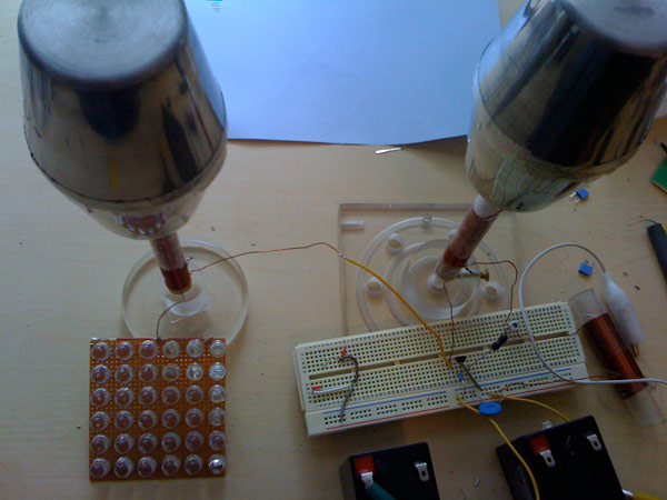

I got all my parts assembled, but no luck so far. My first attempt with whatever I could find was at least lighting up a fluro and/or a neon, but for some reason I cant get any action now.
I changed everything I could to get it as close to spec as possible. The cap I got looks like this: http://i20.ebayimg.com/06/i/000/a9/d6/9552_1.JPG
400pF 500v silver mica, is this suitable?
I tried a number of home wound coils in place for L2, some formed on sewing machine bobbins like the documents shows, some in single layer solenoid style. With and without ferrite rod.
C2 is a 3 -20pF tuning cap, C3 is 0.009uF (measured) 3KV, LED's are 36 x 10mm super bright, 3v @ 20ma, all in series with 1n4148 plug. Tower cups are aluminum, as close to spec as I could find.
Coil former is 12.51mm and gauge of wire is SWG25, digital calipers measure it at 0.58mm including insulation. This is perhaps the biggest variable from the Docs plans. I can try and track down some AWG#24 to see if it helps. Connections are cleaned and taped with a small strip of aluminum tape to the cups. Cups joined with same tape.
Ive double checked all connections, and I hesitate to solder everything in because I cant even get a whisker of light with the breadboard.
Analogue milliamp gauge moves slightly (in the 1-30ma range) upon connection of the power source. I just connect it every now and then to check it is conducting. It gets left out for testing, so as not to effect the circuit.
If anyone has any suggestions I am all ears. I remember Lidmotor saying something about not being able to get it to work without the tuneable inductor, is this necessary on some builds?
