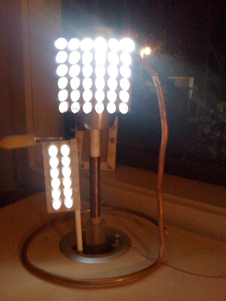

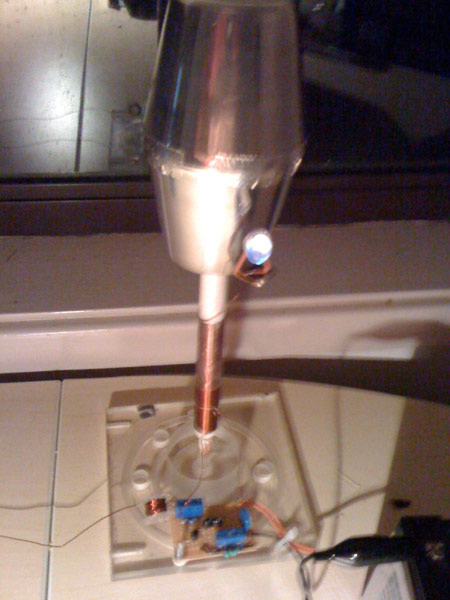

    Here's some photos which you may find somewhat puzzling and worth considering.
    When the inductance in emitter-base coil is reduced the AV Plug+LED array connected to the ground (on the right in photos) is all lit but the AV Plug+LED array between it and the Exciter is not.
    What do you make of this?
    It looks to me there simply is not enough energy being cohered/converted from the environment to light all leds. So, one of the coils will suck up all the energy and nothing is left for the other. Since the coils are never 100% equal, once one of them comes into resonance, there will hardly be any energy left for the other one to pick up, even if they are 99.999% equal.
    It might be interesting to see what happens if you raise the frequency of the oscillator to make more energy available, which should happen if Naudin's paper is correct. If I understand the circuit correctly, you can try to lower the base capacitor from 400 pF to about 100 pF (take a trimmer, so you can adjust). That should double the frequency. And then see if you can find a resonant point.

      OK, not many takers in a day.
      Here is my understanding, if I'm ignorant, then I'm sure I will be corrected and gain from that.
      I can not describe precisely what is going on, but as I see it, the LEDs have to get a sufficient voltage to be lit.
      In both examples the weak group of LEDs is just barely lit, so voltage is present, but not enough to give strong light on the weak group..
      I think by varying the frequency you move the location of the standing wave voltage node(s) relative to the anti nodes (zero or close to "zero") represented by ground and the collector of the MPSA06.
      The group "seeing" the major part of a voltage node is the one most bright.
      Eric
      • @Lattice333
        The fact that one group is barely lit, is actually quite smart illustrated by using 10 and 11 LEDs in the two strings in a group,
        It is then a kind of "VU meter" like the ones used on the old days on the tape recorders (yes I'm that old), a simple but accurate measuring instrument, bright idea

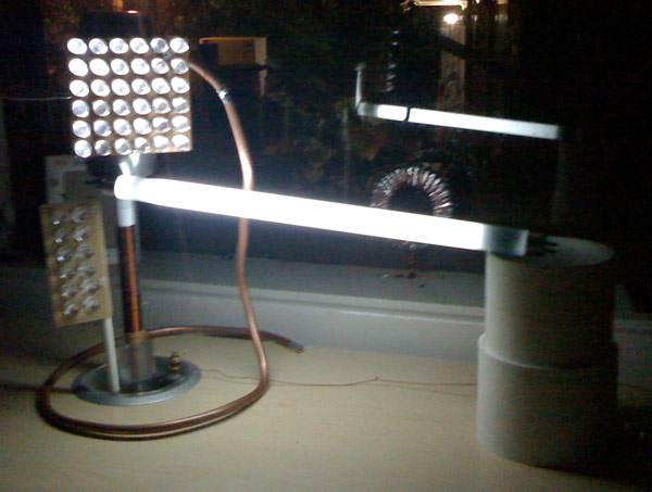

        • I got my setup working properly.
          Ive been playing around with lighting the led panels wirelessly, with them in close proximity to the receiving tower. The Towers are connected on one wire.The lights are slightly brighter when they are grounded, or in this case connected to a large metallic surface. Their intensity can be increased by placing them almost ontop of the "cups". I have a little copper tab that protrudes from the base of the cups, its where the top of the coil connects. It seems to be one of the hot spots, especially when lighting up that fluro.
          Lots of other interesting effects...

          • Puzzle responses
            @ Lamare & @ Eric
            Thank you for your responses. Eric the VU meter is a good analogy. A visual display which helps to see where the energy is flowing.
            I have a point to make but it is not "fully formed" and that was reflected in the vaugeness of my question.

                    • Originally posted by ren View Post
                      Ren, i wanted to post some thing but i am blind now after looking at that thanks a lot mate Thanks for posting the trouble shooting stuff, ill be making up a lot of data of this with ours, just waiting for the new boards ATM and still tuning the older ones, have the spheres and electrolyzers built.
