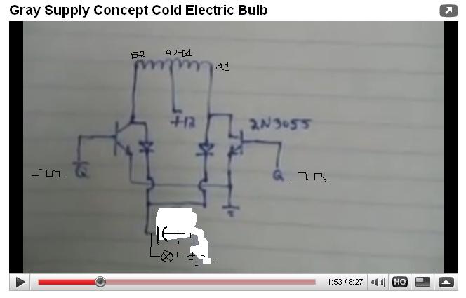

      • Hi all,
        using the circuit attached ( i wil explain where i found it if anybody is interested )...
        the coil is my rodin coil setup as if it were one big winding with a centre-tap.
        the cap is 1000uF, 63V.
        the bulb is a 24V, 3 Watt
        pulsing the two transistors using my 555 ( which includes an extra output which is inverted ).
        The inputs to the two transistors are Q ...and......bar-Q.
        i measure 30.1 VDC across the bulb which is FULLY lit, drawing 0.8A from the source (12V ) battery.
        i can also get a 240V 20 watt bulb to glow a nice orange drawing 0.75A from the source battery and measuring 38VDC across the bulb.
        the transistors get very hot, frequency of pulsing is about 15KHz, not sure about the duty cycle as of yet.
        also had my neo 1 inch sphere inside the rodin while doing this, noticed it jumping quite a bit as i turned the pot to certain positions.
        Im not sure what ive got here ( if anything ! )
        David. D

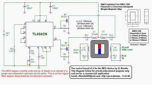

                      • Hi all,
                        using the circuit below from JL Naudin ( MEG ) which is a TL494CN PWM, i have managed to getit up and running..can adjust the frequency using the 22K pot...i also placed a pot in between pin-4 and ground thinking this would control duty cycle.....however this does not work...
                        Does anybody know where i have to put the pot in order to control the duty cycle?
                        Thanks,
                        David. D

                          • Originally posted by rave154 View Post
                            Hi all,
                            using the circuit below from JL Naudin ( MEG ) which is a TL494CN PWM, i have managed to get it up and running..can adjust the frequency using the 22K pot...i also placed a pot in between pin-4 and ground thinking this would control duty cycle.....however this does not work...
                            Thanks,
                            David. D
                            Hi David,
                            I think duty cycle can be adjusted by adjusting the voltage on the feedback pin(3). This is normally used for voltage regulation in a power supply. If I'm not mistaken, max d.c is 48% but it can be made to work up to 100% -
                            Vtech
                            General D.Eisenhower
                            http://www.nvtronics.org
                            • You can vary the duty cycle by applying from 0 to 3.3v to pin 4.
                              Use a 820 ohm resistor in series with a 3.6v zener to ground. Then put a 2k pot in parralel with the zener and take its wiper to pin 4. You will be able to adjust the voltage between 0 and 3.6v.
                              Just search the pdf on this cip. They give you some nice application
                              • Nvisser, thanks, i managed to get it working without a zener until i get one using a pot as you suggested on pin4 taking the VRef from pin 14 and using the pot as a voltage divider.
