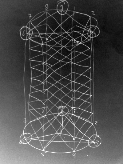

                            • The zero in Marko's geometry is not in the centre. Could you explain in one sentence why a magnet inside a Rodin coil should, please?
                              Taking it over-simplified, I could say the hole need to be bigger, to allow the magnet to spin on the zero location without being bothered by the coil itself.
                              New idea that springs to mind, Rodin fans please read!
                              Can't call it new really, as it's too obvious.
                              In stead of using a toroid, visualize 9 evenly spaced wooden pins, together forming the frame of a cilindrical barel, if you will. A wire is (or 2 are) fed from the off-central zero position at the bottom, and from there the 1-2-4-8-7-5 pattern is weaved.
                              Result is more like a 3-D spider web that a webbed toroid. The wires strictly follow the math, 2-dimensionally, stacking up to a 3D yet coil which might work in 1-dimensional fashion.
                              Has this been done, and if not, why not? This would be a more realistic comparison to a cilindrical coil, and who knows, possibly more interesting than the Rodin toroid vs. a regular spirally wound toroid.
                              The much-discussed spaces for the 3-6-9 would naturally exist, as wires would not wind over the 1-2-4-8-7-5 pins sitting on top of each other. It WOULD be spaced, as in the middle of the stack, the wires need their space to be stacked (compressed).
                              Before I even try to visualize, I bet there would be space left for imaginary or even factual 3-6-9 windings to be made. Magnetricity was recently proven, right? Let the magnetricity be allowed to flow there, if it wants to. I would be most interested in the amount of torque such a Stacked Web Rodin coil could put on a central (maybe off-centre) axle, and/or an outer rotating cylindrical barrel.
                              Please offer your thoughts, as long as they are respectable.
                              I can try to make a drawing, but be warned it will be hideous.
                              Thanks,
                              J
                              LONG EDIT: I made a quick sketch anyway, you'll see it immediately now.
                              Obviously, as I missed before, the 0 point is now a vertical axis cross-crossed by wired. Can't stick a torque axle in there for sure.
                              The 3-6-9 interests me. It could be wound triangularly wound, even V style after the things I've seen with one wire devices.
                              However, it could as well be wound circular, less tight around the pins at hand, space is there for it. It could be a tighter spiral, or wider. Or multiple of varying diameter, to pick up a wider 3-6-9 space, should it be diffuse. I can even see it being a wide spiral or wound triangular plate, intersected by the 1-2-4-8-7-5 wire webs.
                              If it would serve any purpose, the pins could be substantial in diameter, making for smoother winds for the 1-2-4-8-7-5. My uneducated gut tells me it might reduce torque some, but it would also reduce resistance of the coil (shoot me for having just rusty highschool physics).
                              I hope my idea may contribute to better ones from you.
