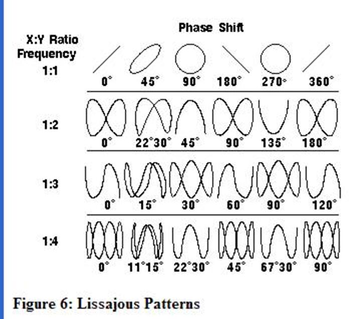

I performed a pretty interesting experiment tonight.
I have two 216uH 5 inch diameter basket weave coils
that I made for some earlier experiments.
I connected one up to channel 1 of the scope.
I connected the other up to channel 2 ... and
put the scope in X/Y mode.
These coils w/o any other components, receive RF up
and down the spectrum ....
On the scope I see a nice 45 degree line because
both coils receive exactly the same RF signals
at exactly the same time.
Now for the fun "human tuning" part.
If I place these coils near each other -- say
3 inch appart or less -- and move my hand
near one ... or touch one ... the
capacitance I can add will boost the amplitude.
That boosted EMF in the first coil is easily received
by the other coil if they are near.
I find that I can apply different amounts of pressure
to the wires, etc. and actually alter not only
the signal strength .. but also the PHASE between
the two coils.
So by watching the scope ... in a sort of biofeedback sense,
I can manipulate the situation to increase the voltage
to both coils and the also get the phase to be exactly
90 degrees different, producing a CIRCLE!!!
See the attached image for Lissajous patterns.
So in the Hendershot design, I would not underestimate the
human ability to TUNE in the exact relationships ...
between phase and voltage needed to achieve
resonant oscillations.Last edited by morpher44; 10-28-2009, 04:41 AM.
