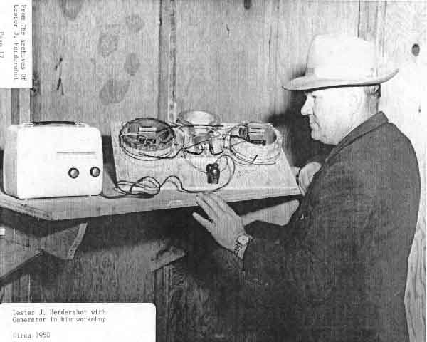

I was thinking the inductance and capacitance of the
tank circuit was the dominant set of values for tuning as well.
But now I'm not so confident in that assumption.
The 120uH you assume is not actually what will be seen
by the tank circuit.
Inductance is a funny thing in that it is influenced
by mutual induction as well.
So since we have a 64-turn coil UNDER that "tank" coil,
it behaves like a transformer.
The other side of that transformer has several other
inductances hooked up in series.
The tank circuit, therefore sees a much larger inductance ...
upwards into the millihenries, since we
are dealing with those 5:1 transformers, etc.
Again, I'm no expert in circuit analysis ... and
all this crazy mutual inductance makes the problem
quite complex.
I have clued into the fact that if you can make
all these inductances experience the same rising and
falling magnetic field (up and down the sign wave),
you utilize the phases to create a nice
180 degree phase shift. One transformer ... gives you 90 degrees.
A 2nd transformer gives you another 90 degrees, resulting in 180.
With a 180 phase shift you can then do "regeneration"
of the waveforms ... adding their amplitudes...
So if the waveform -- arriving to the left-hand side were to be
run through essentially two transformers -- each shifting phase
90 degrees .... when that arrives to the right-hand side,
it too would produce magnetic fields that go up and down
in the same way. The left and right could be made to
synchronize in this way since their fields are moving in
unison up and down on the same plane. They
would be able to exchange mutual inductance ... producing
an even larger effect in terms of feedback.
I suspect the Hendershot device is using mutual inductance to
some advantage.
