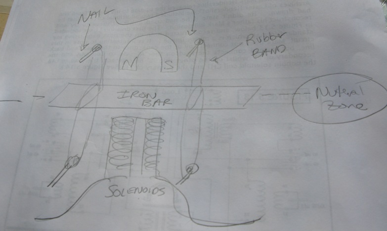

@synchroOriginally posted by synchro View PostThe soft iron bar can be attached to a small board that protrudes enough at the ends to permit a few holes to be drilled through. Elastic can be attached to the sides and the bottem of each end. A loop of surgical tubing could be placed through the sides and bottem of a peach box, so the iron bar is spring tensioned in two directions. A wire, bare leads clipped to each end of the bar and passed next to a magnetic compass, will move the compass needle one way then the other as the bar passes through the neutral zone of the horeshoe magnet. Next comes drawing the magnet down perhaps sandwiching a handfull of playing cards removed one at a time untill the compass needle spins. Then the magnet can be clamped down. Now a door bell ringer can be positioned beneath the tensioned magnet and board, ready to vibrate. This is the simplest approach I could imagine. Output coils can generate current inductively, or wire raps can go directly over the center of the iron bar armature.
A picture would help.
Here is a crude one I drew real quick.
I was thinking for nails to prop up the iron bar
with some elastic bands ... and then the horseshoe magnet
on one side ... and the solenoid on the other.
Bar to be placed in neutral zone.
Something like this?
Spring tensioner.
I'm in Ecuador in an internet kiosk and I can't speak Spanish well enough to get my sketch scanned in right now without an interpreter. Your sketch is excellent. The magnet attracts the iron bar, that's why the rubber bands from the bottem to the iron bar do more work. I thought it might help to run the top ones off to each side to resemble the letter T not the letter H as in your sketch. Thusly tensioned, the magnet will hold the iron bar up with the tension of the four elastic bands pulling down. A handfull of playing cards placed between the magnet and the iron bar, then removed or added to, one by one, untill the bar measures a movement in the compass needle, will produce a permanet spacer consisting of the number of cards. That space will remain constant. The magnet has to be attached to the iron bar with the cards in between, then the magnet needs to be streched upward with the bar untill the cards slip out from between them. This is where the magnet needs to be clamped down. Vibrating the iron bar with your finger should produce clockwise and counterclockwise direction movments in the compass needle. Now, if you glue the self oscillating relay directly onto the the underside of the board, the vibrations alone should begin to generate enough current to light a bulb through your induction output coils. Thanks for following me so far. It appears you have a complete understanding of the area at this point. I'll be looking foward to more updates on yor progress.Last edited by synchro; 10-23-2009, 03:28 PM.

I messed around with this a bit last night.Originally posted by synchro View PostI'm in Ecuador in an internet kiosk and I can't speak Spanish well enough to get my sketch scanned in right now without an interpreter. Your sketch is excellent. The magnet attracts the iron bar, that's why the rubber bands from the bottem to the iron bar do more work. I thought it might help to run the top ones off to each side to resemble the letter T not the letter H as in your sketch. Thusly tensioned, the magnet will hold the iron bar up with the tension of the four elastic bands pulling down. A handfull of playing cards placed between the magnet and the iron bar, then removed or added to, one by one, untill the bar measures a movement in the compass needle, will produce a permanet spacer consisting of the number of cards. That space will remain constant. The magnet has to be attached to the iron bar with the cards in between, then the magnet needs to be streched upward with the bar untill the cards slip out from between them. This is where the magnet needs to be clamped down. Vibrating the iron bar with your finger should produce clockwise and counterclockwise direction movments in the compass needle. Now, if you glue the self oscillating relay directly onto the the underside of the board, the vibrations alone should begin to generate enough current to light a bulb through your induction output coils. Thanks for following me so far. It appears you have a complete understanding of the area at this point. I'll be looking foward to more updates on yor progress.
First off ... I tried to find the neutral zone using the technique
of having a coil around the metal bar and running that off
to a wire to influence compass movement.
FAIL!!
I could see the compass move ... but it was influenced more
by me just moving the bar ... i.e. no current being induced
in the wire ... just wiggling magnetic fields within proximity
of compass.
I then tried Wesley Gary's technique of having a tack
stick to the bar and gradually moving it away until the
tack drops.
What I found was that the tack would drop in various
distances ... so I thought I'de keep marking them and
look for a statistical cluster.
Surprisingly, this technique doesn't offer a tight little
cluster but a rather wide variance.
The center or mean is a increadible 5.25 inches
from the horseshoe magnet -- which really surprized me.
BUT ... the cluster is upwards to 1.5 inches thick for
that neutral zone.
I found that it really depends upon how shaking my hands are too.
If I'm very gentle and steady, the tack might fall
very far from the magnet.
If I and quick, jittery, bouncy .. the tack falls sooner
as its easier to break it off the iron bar due to the vibration.
Bottom line ... that approach of finding a so called
neutral zone is highly "noisy" and only gives a ball park.
So I put the bar in that mean location and messed around
with pulsing my solenoids near it as it hangs from
rubber bands.
The mechanical dampen oscillations are impressive.
At certain pulse frequencies I can make the bar vibrate
dramatically .. to the point that the swings are so wild they
BANG off the metal of the solenoid. Mechanical resonance --
great fun!!!
However, I am not noticing much in the way of induced currents
in the Hendershot coil.
Anyway, this approach is interesting ... but nothing dramatic
has been found yet ... other than the fun of messing
around with mechanical oscillations of a bar suspended by rubber
bands.
Elastic vibration.
