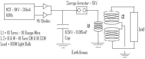

Some success
Hello everyone!
I have been following this thread for sometime now and have tried different setups to power a load on the L2 coil in Don's setup.
I wanted to report that I had some success with Don's setup. Please see the attached circuit diagram for my setup.
L1 coil was wound on a 2" PCV tube and placed in the centre of L2 coil. L2 coil was from Baker and Williamson with a 3" diameter (Model 2404TL). I removed 4 windings from the center and attached a ground lead to it. The outputs from L2 coil was connected to a 100W light bulb.
I was able to light the 100W light bulb fairly well but it was not at full brightness. I did run into some problems and I was hoping someone in this forum can help me solve. I used a surge arrestor with a breakdown voltage of 5KV but after about 5 mins of powering the device the discharges from the primary capacitor goes over the surge arrestor casing and creates a loud sound. I was trying to eliminate the sound all together since a working model should be quiet as well. If any one can suggest a different method for the spark gap with little sound as possible, I would appreciate it.
As the device is left running for a bit there would be sporadic growth in brightness on the 100W light bulb. I assume this is caused by the coils going into and falling out of resonance. I still need to find a method of tuning this device for maximum effect on the L2 coil.
I will post more pictures of my device once I get back home tomorrow.
Thanks.

congratulations!
. That is very good news for all!
Please specify what measuerement equipment you have available. Else you get probably hints you can not follow.
Have you arrestors with i.e. 2 KV? Then use two of them in series.
Are they getting very hot? Use fan for cooling.
rgds JohnLast edited by JohnStone; 11-26-2011, 07:53 PM.Experts spend hours a day in order to question their doing while others stopped thinking feeling they were professionals.
Hi,
I will post my exact measurements on the coils and the equipment I have for taking measurements tonight once I get home. I'm away from the work bench at the moment and dont' have all my notes with me.
I also have a 2KV arresters and I have already tried placing 2 of them in series. They still get really hot and the discharge jumps the outside of the casing. So far I only had some what a stable oscillation with a 5KV arrester. I also tried 100V arrester and 3 100V arresters in series and they gave no visible output on L2.Last edited by Blue_Serge; 11-26-2011, 07:58 PM.

Typically when the NST output is rectified in that manor the power consumption is cut in half or slightly lower. I was curious if Blue Serge was able to get it at or below the 100 watt input. Still, the bulb really isn't a good indicator of the actual output, simply a visual representation of work being done. It's quite difficult for our eyes to process the difference between 70 watts to 100 watts of brightness so it might seem to be full bright but without an actual measurement it's a guessing game.
I haven't seen any spark gaps, pre made, that are enclosed such as the GDT's. The GDT's run extreemly hot and typically don't last long. I've been using some home brewed gaps using Tungsten in open air and they are a bit noisey. I was thinking it wouldn't take much to take a lab type glass tube and insert aluminum ends, one rod being fixed the other being threaded and adjustable. This would keep the noise level quite low and would operate better than the GDT's.
Hello,
Thank you Zilino for your advice. I will try your suggestions next.
The input power for the NST is 240 watts. (120V * 2Amps)
This system is still far from overunity, however it is a step in the right direction. I will try the this again with a third coil and see if that makes any difference. I'll keep you guys posted. Thanks.
