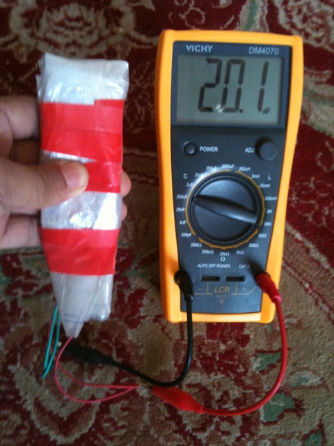

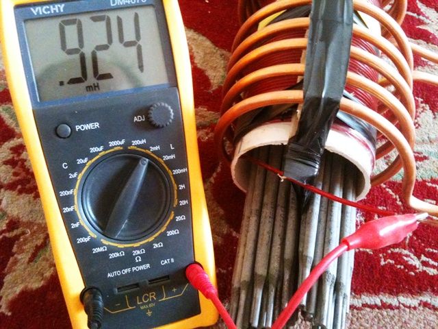

hi allOriginally posted by zilano View Postu can use lcr meter to check capacity of home made caps. needs some hit and trial methods to get 200 nf
i get 924 uH for L1 coil by using welding iron rods and 20.1 nF homemade for 36.93kHz
thanks to all
Did you test your coil's own self capacitance & factor that in???Originally posted by Eng.raied View Posthi all
thanks to all

Well done anyway, looks like a nice little set-up. I suppose I should get off my backside & make a start on mine!
