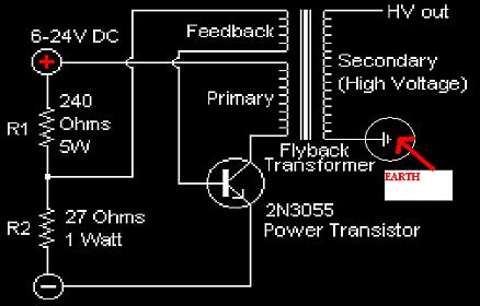

  • Originally posted by zilano View Post
    keep the cold end of ur hv coil earthed to prevent shocks!
    rgds
    I think they were still "live" even with the earth ground in place (the pic is not how I had it running, I had the coil on the right (reverse Tesla) disconnected, as it was just losing the sparks (obviously as it's not been tuned yet).
    I separated the LV side of things to a different board, like so......
    But then things got even more strange. I couldn't get any sparks across the gap unless I held a grounded earth wire CLOSE TO the variable resistors, or unless I had my insulated pliers touching the variable resistors (I wasn't going to tune them with bare hands again!).
    This is all very strange. But if I touched the earth wire onto the 47k variable resistor it sparked inside (& smoked), if I touched it onto the 4.7k it made the sparks at the gap stronger.
    I had 2 grounded earth wires at this time, one was connected to the cold end of the coil.
    All very strange
    I'm guessing it's feeding back somewhere, maybe there's something wrong with my variable oscillator???
    Here's my HV coil......
    Should I have both HV wires coming out the same end???
    I have a 2N3055 transistor, maybe I will just make up a fixed oscillator circuit with the base wired to a 4 turn coil, as per Patrick's other schematic???

      • Proper ground
        Shocks are the result of improper grounding. Earth is a large electron source or sink. You don't want to mess with Mother Nature... Make sure that anything you plan to touch is within a few volts of earth ground and limit the current that can flow through you to earth ground by appropriate use of resistors.

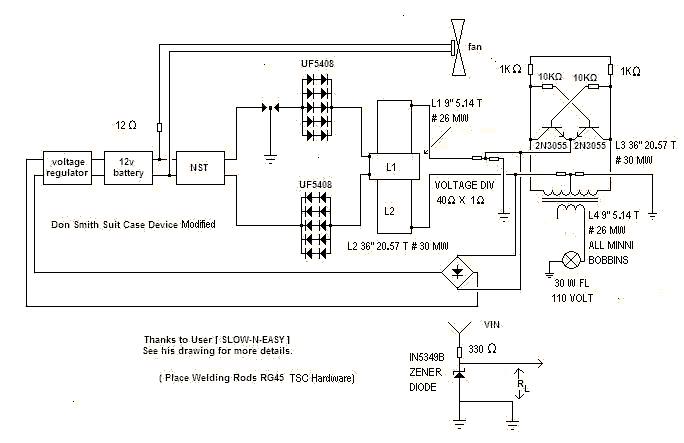

                            • Hey People
                              I am posting a new schematic on the Don Smith based device I have built and I have made some changes
                              that a lot of you will not understand. I have taken out the capacitor after the step up because it was just
                              slowing down the ciruit and would not function right. I can't tell you why this is so. I just know what
                              is working for my system. I currently have diodes after the NST but I', not sure yet if they are helping or hurting.
                              But when I took out the caps my device just sprang to life. I had tried the caps in series and parallel with just problems.

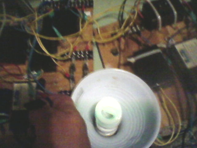

                              And it is in resonance. No doughts Also I will post a picture of the lamp litt and me touching the ground to the other side of the plug prong
                              So here it is without caps and it is in resonance. So take or leave it this is what I have come up with and it works
                              This is a working Don Smith based device. mine just puts out AC and could easliy put out DC like Don's
                              So all this crap about how Don's devices don't work is B.S.. You just have to make some adjustments.
                              Like he always aid He was not giving all the information for a working Device. You have to work for it.
                              All aspects of this device works including the self charging battery, I need to run some more tests on it but its charging around 12v.
                              The charger with working schem and diodes and resitors is posted. And it has changed sence my last post so make note.
                              I have no doubts that this can be replicated buildt just like this and you can use feet instead of inches in the coil wire length.
                              Sense I used minni coils for my transformers.Which are just as powerful as pvc tubing coils. Best of Luck.
                              S-N-E
