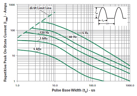

            You only need the IGBT if the current goes over 1Amp.
            Otherwise it works with just series SIDACs.
            Actually the can take a bit more if pulsed.
            (See attachment)

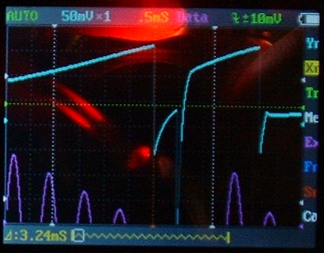

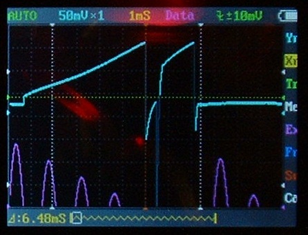

                      • I tried the 1006volt series SIDAC on the ignitioncoils but for 2.38Amps input I got 200mA output.
                        Seems It has to be done like a real sparkgap, shorting the charged cap to the coil creating a resonant ringdown.

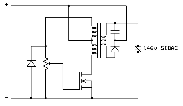

                        It was more fun with my mosfet JT though.
                        I used a 5.6uF and tried to charge it with the secondary flyback but it wouldnt charge to more than 30v.
                        I changed it to a 330nF cap and a 146v SIDAC back to the battery.
                        When I connected the wire to the battery, there where sparks
                        I connected the DSO and for sure there was a huge pulse feeding back.
                        5times larger than before or about 850mA in each pulse
                        Now I have trouble with the mosfet striking again when the pulse feeds back to the battery.
                        I need to find out why.
                        This was fun though.
                        Would not have thought that with just a 330nF cap and a 146v SIDAC
                        Enjoy while I draw the schematics.
                        Edit: Seems I turned the 5.6uF polairized cap backwards.
                        Have to try it again.
                        • When the cap is charged 146v over the battery voltage, the SIDAC fires and dumps its charge to the battery.
