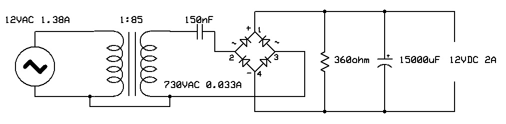

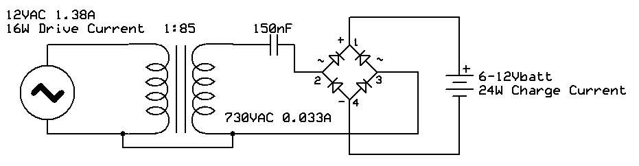

  • Now this works and it works very well.
    It charges the battery very fast.
    Even if the battery is a total short it does not disturb the resonance.
    I call it the Quadraverter

      Hi Janost,
      you always come with something elegant and incredibly simple. This time it is no exception. The circuit seems deceptively simple.
      I guess the input frequency is 50 Hz, as the ignition coil (1:85) is designed to work at a maximum of 5KHz. The bridge rectifier is a conventional one, not necessarily an ultrafast one.
      I wonder if you checked the phase shift of the output of the secondary to see whether it is at 1.0 ? On the contrary, the power calculated should take into account of the phase angle.
      The only loss in this circuit would be the heat loss within the coil and the bridge rectifier.
      Are you claiming any OU effect for this circuit? If so, a scope shot of the output would be interesting though.

              Yes, I'll scope it and show pictures but I already know from previous measurements with a 150ohm resistor in series that there is 33mA in the secondary at resonance.
              There was a 5v drop over the 150ohm resistor.
              The LC combo have a Q=2.
              I'm not claiming anything yet but I do know that you can short the output and the input current is still 1.38A
              Dont leave the output open or unloaded, that kills the resonance.
              Yes 50Hz.
              To use it at 60Hz change the cap to 105nF.
              The phaseshift between the primary and secondary is 32deg.
              It actually puts the battery into the resonant circuit so the sloshing currents have to pass the battery.

              • It can be done this way also.
                The 360ohm resistor limits the charging of the cap to 12v.

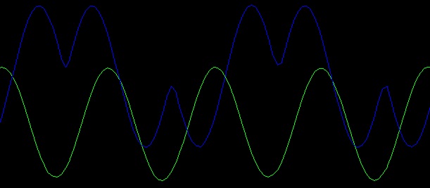

                • This is what LTspice says with a 360ohm resistor.
                  The green line is input power and the blue line is output power.
