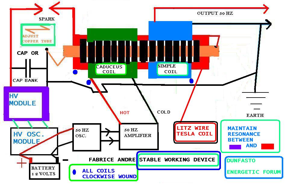

        • fabrice andre final stable circuit
          hi utopia and others
          dunfasto
          • Final stable circuit
            Hi Dunfasto,
            I am thinking and tinkering and enthousiastic.
            Thanks to the different schematics you offered about Donald Smith devices and device and Akula and SR193 and Dally Nanopulser and Caduceus winding and the extra info about working principals ... Now i am getting a better understanding of the whole picture ( i think ..
            For new comers .. i put the info in this prezi document ( DonZ Device ) that you can vieuw online and can copy and download.
            Still trusting to receive some parts and litzwire on my doormat the coming days.
            I am positive and grateful and happy
            Utopia

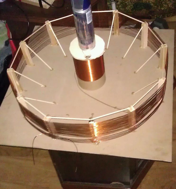

            • new vid
              me again, thought i'd share this here. i havent given up on any past projects, just couldnt resist
              part 5: Colorado Springs Model
              TMT 5 : Tesla Magnifier: Colorado Springs Model - YouTube
              *Tuned for 503.4kHz*
              L1 5 turn 22" diameter 14 gauge
              39.98uH and 2.5 nF tank circuit
              L2 31 turn 22" diameter 24 gauge
              930 uH and 48pF self capacitance 2141" wire length
              L3 165 turn 4.13" diameter 24 gauge 4.13" tall
              1888.1uH and 4.8 pF self capacitance 2141" wire length
              (sec and extra coil equal lengths, both 1/4 resonators?)
              Top load Capacitance 25 cans = approx 47.2 pF
              sec self capacitance almost exactly equals extra coil topload capacitance, interesting, maybe coincidence.
              Anyway, seeing more amplification here with less turns, than my taller high turn secondary with same voltage input
              still early stages
              -Shunryu Suzuki
              • Nice Transformer !
                Well done mr clean, nice work, I like your top load, very ingenious. Awesome
                result as well. Looks to be in tune and working just nice. You got your frequency
                down which is important, but the sacrifice will be in the "Q", we cannot have
                everything though in a table top setup, mine is higher frequency with less top
                load capacitance so I compromise with more radiations. I will get the
                frequency down somehow or with another build sooner or later.
                I've been a bit ill lately and so only just now noticed your setup and what you are
                working on. I like it.
                If you measure the resistance of the secondary and the extra coil in total then
                convert to nH and Ghz you can use this calculator to get a rough idea of the "Q".
                Tools - Circuit Sage
                This calculator can be handy for tuning the circuit sections as well, ie resonant
                charging circuit components ect. if you use one or for other stuff it's handy too.
                Capacitive | Inductive Reactance Calculator
                Well done, that is a very good result just from the first one video "TMT.5" I watched.
                Keep up the good work and be very careful, you are no use to us cold.
                I'll watch some more video's when I get time. Remember to observe as much as possible
                and try to do the experiments that come to your mind, formulate your own experiments
                and keep having fun, I smile when I hear the hahaha or hehehe, nothing like the smile and giggles
                it gives to see the coil working well and energetically.
                P.S.
                I see you are using a grounded wire which is a good idea for sure, smart man.
                Sounds like your break rate is nice and high but if the transformer is
                conducting hard you can hear the rate of hard conduction is quite low, that is
                what make the HV discharges dangerous, I would not allow a discharge from
                that to pass through your body, ie. if you were to hold a fluro tube in your
                bare hands up to the Top terminal or even the secondary you might get a
                series of bad shocks at the lower break rate of the input. And that does not
                feel nice at all when the volts get up in the 100 k range.

                    i appreciate those words, and coming from you, that means a lot you have great stuff beyond my knowledge.
                    yeah i really dont like shocks from this one it's a strange thing with this setup.
                    i can usually touch the spark no problem, different here.
                    since the vid i have made more calculable alum duct tubing, 4" dia tube, 19 inch dia toroid seems to give the same as the cans ( which have many surface inconsistencies)
                    more to come
                    -Shunryu Suzuki
                    • great build, Mr. Clean!
                      @Mr. Clean
                      Hello Kurt,
                      thanks for another great build you are sharing with us Really impressive, i just L VE it !!!
                      I have watched your video for a few times, just to soak up every detail and enjoy some great sparks (I have to agree with Farmhand, please be careful, we wish you not just a happy, but also a *LONG* life )
                      There are a few things I would like to ask you about it:
                      - are there no diodes at all?
                      - are the two cap banks that are in series with L1 of equal capacitance? (i.e. 2.5nF for each of the two banks?) Could one of them be omitted, if the remaining cap bank's capacitance value was altered properly?
                      - (even if it may not make a difference, since all coils have equal winding orientation) Your setup in the video has exactly opposite winding orientation (all CCW) than in the schematic you have shown (all CW)?!.
                      - the whole primary setup somehow looks like a Tesla Hairpin configuration, right?
                      Thanks again + stay healthy
                      Best wishes from Austria!
                      kexos
                      • Originally posted by kexos View Post
                        @Mr. Clean
                        Hello Kurt,
                        kexos
                        thank you sir, yes it's getting there
                        yeah im careful these days
                        -no diodes, these caps are not DC pulse caps, they are ceramics 40kv .001uf each
                        -there are caps distributed on both legs of the same primary, i did that to be able to put several in parallel to avoid heating, while at the same time 5nF + 5nF in series ends up being 2.5nF perfect tune for my purposes
                        (it's a weak link to have a heavy primary etc, but expect it to run thru the tiny single cap wires )
                        -Hehe, well you see, your transmitter and receiver should be wound in opposite directions to compliment one another it has been written by E.Dollard as well, can be either way, but as long as all coils on the same device are the same direction. i am not sure what the effect of 180 degree phasing the primary/secondary would be or if useful.
                        But one thing for sure is to make sec and resonator same direction.
                        -yes good eyes, the primary coil could be replaced by your bulb just great as hairpin circuit, but you cannot exploit the rise of the resonator without inducing the secondary
                        hope that helps
                        !!one thing also, space out your primary turns, i have found out that the same number of turns close together kills transfer to sec from too much distributed capacitance (could be something else) but i have seen the same number of turns and length of wire do some very different things when spaced out enough to do their natural reactions
                        -Shunryu Suzuki

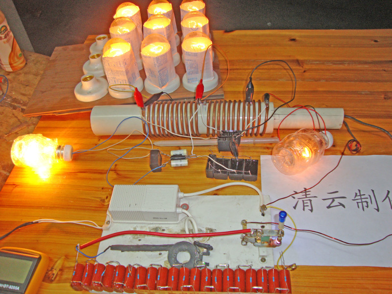

                            hi!
                            reverse tesla with cw and ccw coils
                            dunfasto

                            • Привет dunfasto
                              Chinese replica is not Over Unity. Something more is missing there. But in any case regards for persistent experimenter Chun Yung.
                              Go on Selfrunning Free Energy devices up to 5 KW from Tariel Kapanadze
                              you will find somewhere in the middle reference manual how to proper construct and trim Tesla Transformer and how to tune him with signal generator and oscillograph. You will find working schematic using TT which have gave 7kW output power from input about 150watts.
