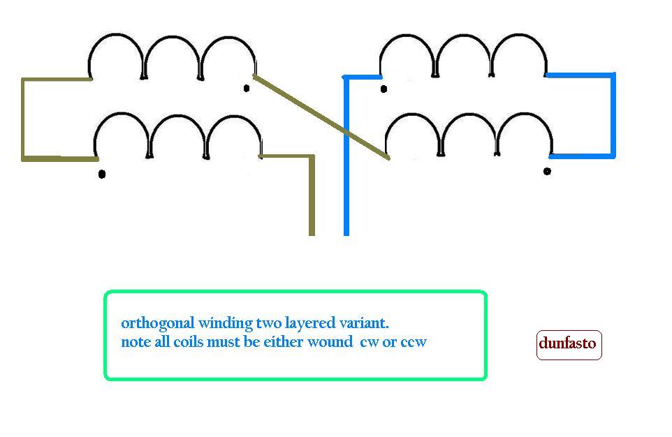

          hi utopia !
          orthogonal coils two layered. you will be needing this for ou.
          dunfasto

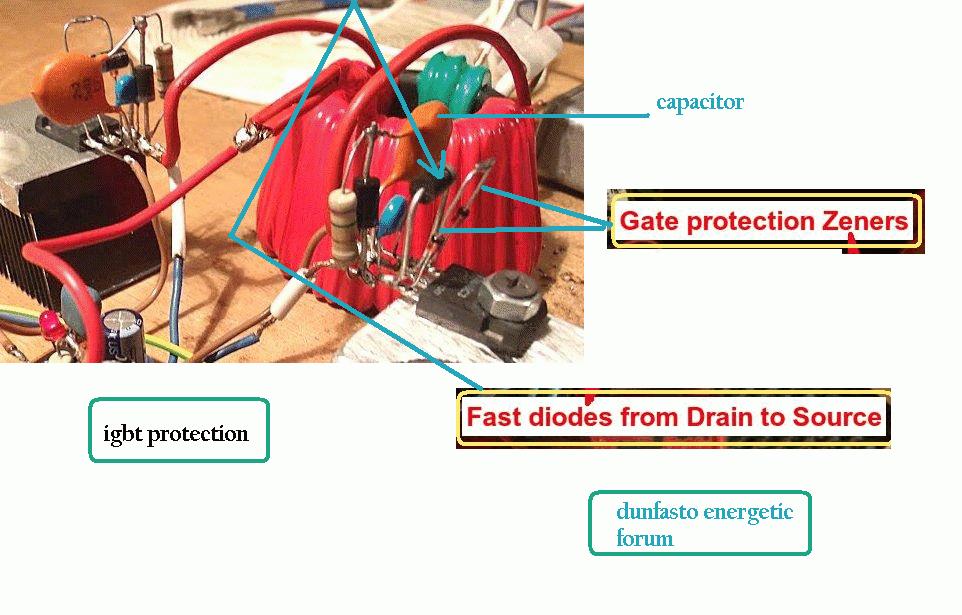

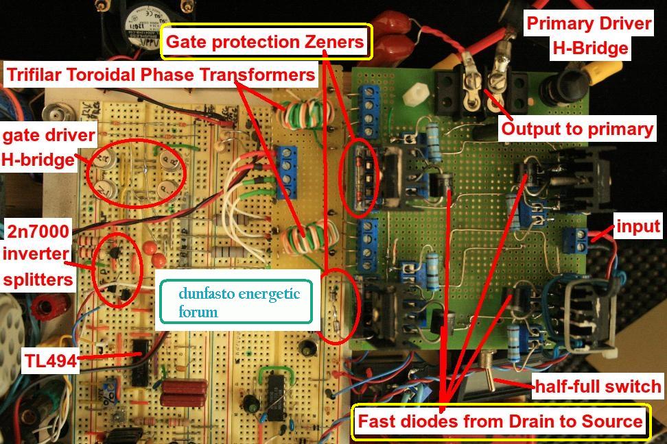

                    • igbt or mosfet protection from frying!
                      read to understand 494 and phase splitter for driving mosfets or igbt.
                      Kapanadze Cousin - DALLY FREE ENERGY
                      dunfasto
