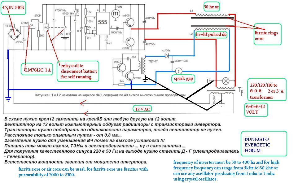

          • Originally posted by GSM View Post
            Hi Dunfasto.
            Look at the oscillator you say is 27kHz.
            The oscillator does not have a negative DC power supply and the transformer secondary is not connected. It cannot work !
            What kind of ferrite.
            Are the coils bifilar, or layer, or side-by-side.
            When switching transistors overheat then they are not being used correctly, they should run cool.
            Cheers ............. Graham.
            coils are simple wound. one over the other. single layer.
            you cannot avoid heating of transistors in an inverter circuit. and a fan is must as in all inverters heat sinks are must for driving transistors althogh a fan must be there too but inverter manufacturing companies dont install fan in low cost inverters to increase spare parts generated income or revenues from repair and maintenance. high costing inverters always have fans blowing the heat sinks or have exhaust fan working.
            our aim is to produce nucleons not electrons. nucleons are of two types called techyons the plus and the minus. they are very veryyyyyyyyyyyyyyyy smaller than electrons or protons or neutrons
            see the complete circuit and your doubts and questions that are spark like will be quenched without tesla magnets.
            dunfasto

            • Originally posted by SunofFather View Post
              That schematic can be joke. Here translation "In Scheme kren12 to replace or any other kren8B 12 volts.
              The fan on the 12 volt computer blew radiators with inverter transistors.
              Transistors need to pick up on the same parameters, then the fan is not needed.
              Distance only by experience - from 0.8 mm ... (probarly spark gup distance)
              ground needed to reduce high-frequency noise on the output of the divice!
              While it is possible to feed the lamp, toasters (heaters) and elektromotors well and selfrun ...
              To get hight quality sine wave 220 50 Hz in output should put M - G (motor
              - Generator).
              Naturally power depends on the inverter power."
              I not translate top text.
              It is "Coil L1 and L2 winded on carcas (tube probarly) diameter 40 milimeters, each have 40 turns insulated wire (who have many tin wires inside) 1 mm2."

                  Hi Dunfasto,
                  So the coils are simple wound over a ferrite based sleeve core; first L1 (80t or 40t inner?), then L2 (80t or 40t outer?).
                  Please excuse my questions, because I try to not make assumptions in the absence of clarification.
                  If L1 and L2 are meant to be beside each other as a single layer then this device could not work.
                  I have been hard on you because of the circuit errors, but you are replying, so I shall continue.
                  Your low frequency output stage needs to be made into a complentary push-pull output arrangement with intermediate driver transistors and output device emitters connected to the power rails. This so that the output device collectors switch hard towards the rails, drop very little voltage whilst conducting, and thus do not get warm. I also think that reversed biased diodes between the output terminal and rails would be sensible.
                  I do not have any links with this company, and they are most certainly not cheap, but they do sell a ready made alternative -
                  Power Pulse Modulator - Pulse Width Modulation control circuit for high current low voltage with built in protection
                  Thank you. You have wired in the missing power rail for the HV self-oscillator, and its step-up transformer.
                  A ready made alternative is also availble for this - inside the base of a toy plasma ball.
                  However, my earlier comment relating to Earth connections still applies.
                  Check out the 12V supply rail Earth at the left of this circuit.
                  Also check the lamp load plus self run transformer Earth.
                  Now check upwards and left from this lamp Earth - it links back to the PCB - to the junction of two capacitors.
                  Thus an Earth loop is short circuiting the lower of those two PCB rail connected capacitors.
                  This means that if this circuit diagram is accurate, then L1 is running with a pulsed direct current, and not an alternating voltage !
                  You sure this circuit works ?
                  Also please explain why the Earth grounding wires are necessary, or,
                  has that Earth symbol been used here in place of a common negative rail connection 'Chassis' symbol ?
                  I am not being pedantic here, for there is a big difference between an equipment which must be grounded to Earth,
                  and an equipment capable of independently running anywhere in total isolation.
                  Creating nucleons suggests this device influences atomic nucleii via magnetic field pulsing -
                  yet for nucleii to be affected there must first be electron relationship modification via field energisation ?
                  Cheers .............. Graham.

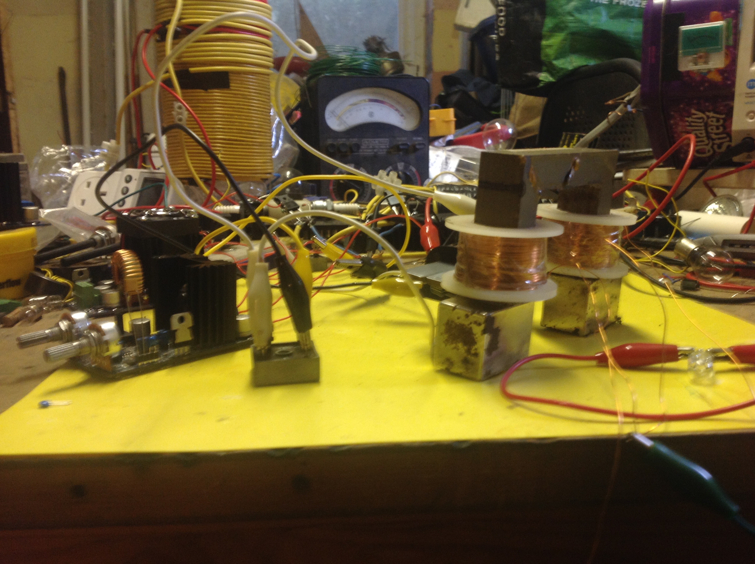

                          hi buddy, sure i show how i am using the bitoroid from past experiments, had tried a basic square wave circuit, then Mazzilli push-pull circuit, which worked very good, and now i want to try out the circuit suggested by JLN Labs for the MEG project, which he did in fact record some overunity numbers.
                          notice i said numbers, cause until i see hard filaments lit, i dont trust fluorescents or LEDs for power out measurements.
                          here for tuning and first time running, just to see if it turned on, used a 12 v LED bulb which had 14.9v -15.3v across it, in an H bridge wave form. pos DC and neg DC square at 18-60kHz 50%
                          fairly pleased so far, but need to optimize some components, and build some LC networks now for that range of frequencies
                          in tuning, i always got a better response with pos and neg DC square wave form, compared to single positive squares, or perfect sine waves, H bridge is better. (pos and neg square wave form)
                          BiToroid Resonant Driver: MEG Circuit - YouTube
                          circuit here.....
                            Hi Dunfasto,
                            Earthing is required so the effect of the tachyons wont hamper the metallic things lying near the equipment saved from being charged and being damaged by fast moving electricity thats affects sensitive devices like cell fones laptops tv and interefere with ac run equipment. earthing prevents! it acts like shielding of faraday cage. moreover one can use alluminium split tube to act as faraday cage within the tube.

                            • Originally posted by dunfasto View Post
                              akula video new!
                              GEDC0625 - YouTube
                              earthwire works efficiently!
                              dunfasto
                              Thanks Dunfasto, but that does not answer my question, nor the thoughts behind it.
                              If the circuit works better with an Earth ground then it must be a field driven Beta release device.
                              Beta release becomes self limiting without a grounding wire (output not maximised), and the equipment might even become a serious electric shock hazard by developing a high voltage if left free standing.
                              No one wants to end up in hospital with a 2KV electric shock like Hendershot did, so maybe someone needs to go over that Akula device with a Geiger Counter, and if necessary provide a warning relating to safety during usage !
