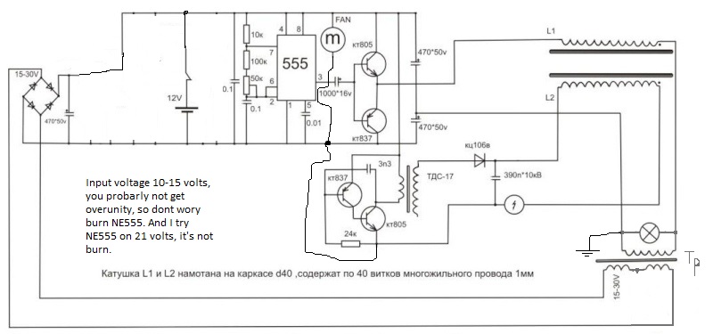

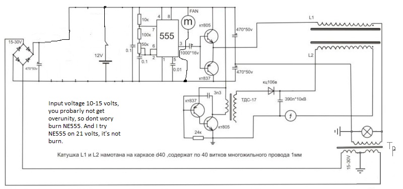

    • Could someone analyse if electronic part with ne555 and two transistors are correct ? Can it provide the required at least few amps of current ?

          • Originally posted by boguslaw View Post
            Good point Boguslaw.
            NE555 has rated output max of 20mA.
            Even selected high gain power transistors rarely better a gain of 100.
            So the output devices will max at 2A.
            Maybe a better standard of 555 timer should be indicated to have "a few amps" at output with such low voltage switching.
            Now I'm expected to believe the circuit operates via Tachyons, and Dunfasto still fails to respond to the Earth loop error.
            Cheers ........... Graham.

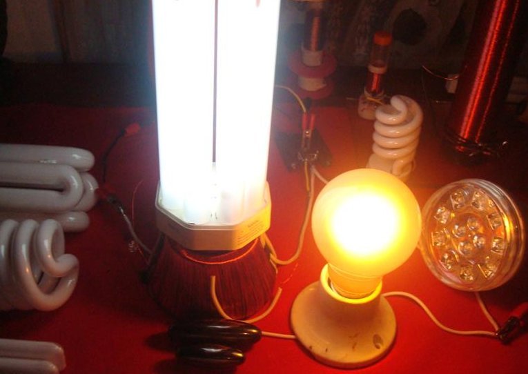

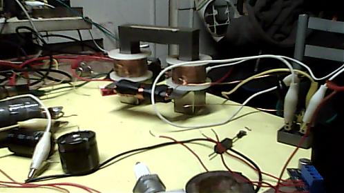

            • Originally posted by mr.clean View Post
              hi buddy, sure i show how i am using the bitoroid from past experiments, had tried a basic square wave circuit, then Mazzilli push-pull circuit, which worked very good, and now i want to try out the circuit suggested by JLN Labs for the MEG project, which he did in fact record some overunity numbers.
              notice i said numbers, cause until i see hard filaments lit, i dont trust fluorescents or LEDs for power out measurements.
              here for tuning and first time running, just to see if it turned on, used a 12 v LED bulb which had 14.9v -15.3v across it, in an H bridge wave form. pos DC and neg DC square at 18-60kHz 50%
              fairly pleased so far, but need to optimize some components, and build some LC networks now for that range of frequencies
              in tuning, i always got a better response with pos and neg DC square wave form, compared to single positive squares, or perfect sine waves, H bridge is better. (pos and neg square wave form)
              BiToroid Resonant Driver: MEG Circuit - YouTube
              circuit here.....

                • Originally posted by GSM View Post
                  Transistors can provide.
                  It seems corect, only maybe capasitor from 3 leg of 555 need remove and replace it with resisor about 50 omhs.

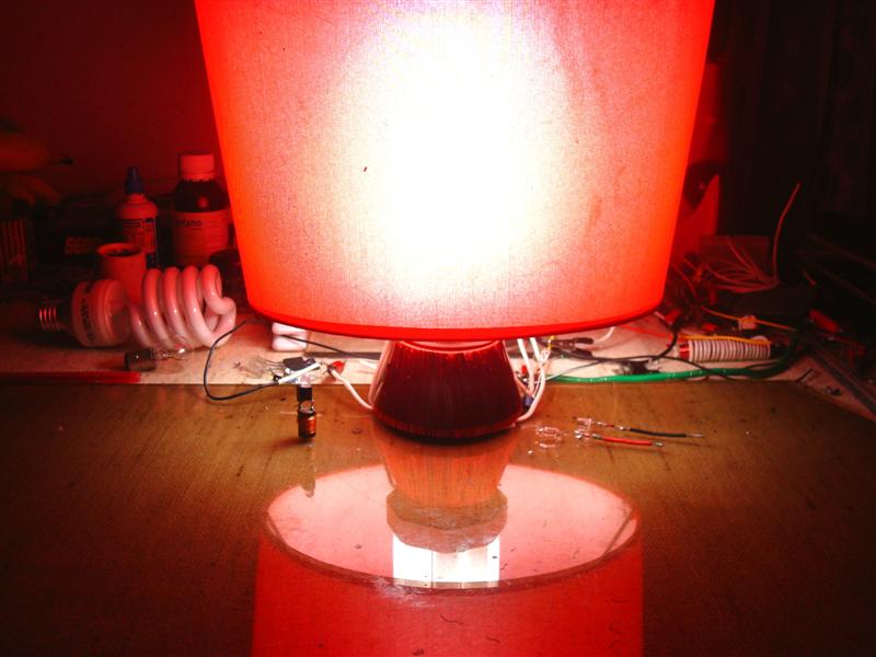

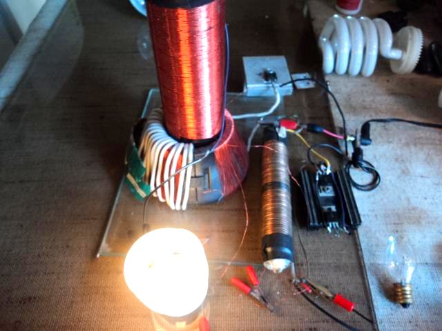

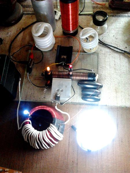

                          • Gedfire:
                            I made several different versions, with different cores, different transistors, connected to many different Cfl, Led, and incandescent bulbs.
                            The main trick is to be able to feed-back some juice to keep the battery up.
                            That I'm still working on. Not easy to do, although the positive terminal of the battery is lighting a neon Av plug, which means that the circuit is feeding back at least 110v or more to the battery, with low current, out of the over 1000+ volts that the circuit outputs.
                            This is a good device to try to obtain a self-runner from.
                            Here are some pics of a few different versions.
                            As well as a video, of my Super Joule Ringer Lamp.
                            Camera battery gave out on me at the end. Watch how the background lights up when I cover the lamp bulb with my hand, as the camera dims the actual lamps light output.
                            Video: Joule Ringer Lamp- Lighting a 65 watt CFL bulb - YouTube
