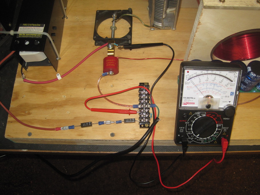

  • Well, I found at least part of my problem. I finally bought an ANALOG voltmeter, I got tired of frying digital ones. Not that I'm careless with them, but operating close to spark gaps and high voltage oscillating circuits does funny things to them and eventually causes damage. I have a 100M HV rated resistor on order but not in yet, but I do have a few 10M film resistors that can take a couple kilovolts in my parts bin. So I hooked up a resistor and the multimeter to measure current through the resistor. To my surprise, C1 is only charging to around 1,000 volts. It should be much higher, 10KV at least. So somewhere I have a conductive path to ground that's leaking enough current to matter, or else my PVM12 is not operating properly. It does light up fluorescent tubes just fine so it's not obvious what the problem might be. So now I need to do more checking and see if there's a subtle leak somewhere. One of the problem with high voltage projects is that we are often using parts that aren't HV-rated, take the terminal blocks for example. Even with proper insulation on the wires, there can be conductive paths through wood or other materials. Exposed joints are a problem. Any sharp points or small radii can have corona loss. The higher the voltage the worse it gets.

                  • Well, at least part of my problem appears to be in the diodes. Those UX-FOB diodes I've been using are rated 8KV but they don't seem to be working right. I substituted the two diodes shown in the picture for a single HVM-12 standard recovery (non-ultrafast) microwave oven type diode and actually got around 3KV on the capacitor instead of 1KV. The "standard recovery" diodes don't actually say how fast or slow the reverse recovery time spec is, it could be fast enough to be useful but I have noticed before when using them that although they do give some rectification at 30+ KHz frequencies, they also get warm and I'm sure there is some reverse leakage during the recovery period every cycle.
                    So I'm stuck on progress until my diodes come in, I have some 30KV 100ns 100 mA diodes on order but coming from China (groan). Might be a week or more before I see them. I did receive my large spool of 40KV wire so I can begin building the coils for the next upgraded version in the meantime, doing calculations now.

                      • Originally posted by tswift View Post
                        Yes 100ma, 30KV, 100NS are perfect for D5.
                        • I haven't been having luck with ux-fob diodes working well either, or cl01-12, if you want something to try in the meantime while your china ones come in try 1n5408 https://www.amazon.com/gp/product/B0...?ie=UTF8&psc=1
                          connected in series in a chain. cheap enough to see if they do what you need. I don't know the specs aside from what you see on the amazon ad.
                          • Yeah, if I had a bunch of 1N5408 diodes laying around it would be worth a try. Regular HV diodes internally are just a bunch of diodes in series, which is why they have a larger forward voltage drop than regular diodes. So it would probably end up acting a lot like the HVM-12 diodes I already have. I notice that the datasheet for the 1N5408 device only specifies characteristics at 60 Hz and doesn't specify reverse recovery time so it's certainly not an "ultrafast" or probably even a "fast" design or they would make a point of it. Doesn't mean it won't work but probably won't work well. Unfortunately there's really no substitute for true HV diodes that are also high speed. By the time you add "high voltage", "high speed" and "high current" into the mix, you get devices that are neither small nor cheap, I paid almost $4.00 each for the 100 mA 30KV 100ns diodes.
                            http://www.diodes.com/_files/datasheets/ds28007.pdf
                            • I should have mentioned, I'm glad to know it's not just me having problems with the UX-FOB devices. They seemed like a good buy for the specs, an 8KV 500 mA diode for not insane money but they don't seem to work well in practice. I didn't know whether mine had just suffered from the various experiments I have put them through or whether it's the diodes themselves. I found a datasheet for them and they look OK on paper, 8KV, 0.5A, 40 ns. I have done some experiments where I got better results with the HVM-12 non-fast diodes even at 30 KHz or higher, so that made me suspicious. I would recommend other experimenters steer clear of them.
                                you could try the Ultrafast version of 1N5408, just replace "1N" with "UF". UF5408
                                75 ns recovery time
                                I ordered a lot of these cut them short, connect by soldering and wrap them with teflon then electrical tape, put it inside a ballpen *case for extra protection and sturdiness and you will have UF high voltage diode with less leakage (its just going to be longer than the expensive ones.), but it works, this is what I use.
                                or maybe the low amp version of it. uf4007 (1kv 1A). these are more flexible and much easier to connect to form like a spiral, so it wont be that long (considering you have to connect 30 in series to achieve 30kv).
