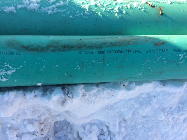

        • Finally I found a 8" pipe!!!
          I may start wind the coil soon

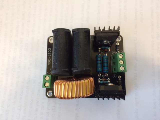

          • ZVS flyback driver
            Here is the ZVS flyback driver I will use for the hv side.
            • Originally posted by Wistiti View Post
              That is fine but the PVM12 is self tuning.
              Mwtj still got his to work with something similar to your flyback driver.
              Mwtj has apparently built his own PVM12 now.
              There should be some new results published this week. I've been waiting very patiently!
                  Where did you find it?

                    • Originally posted by soundiceuk View Post
                      At the city construction department.
