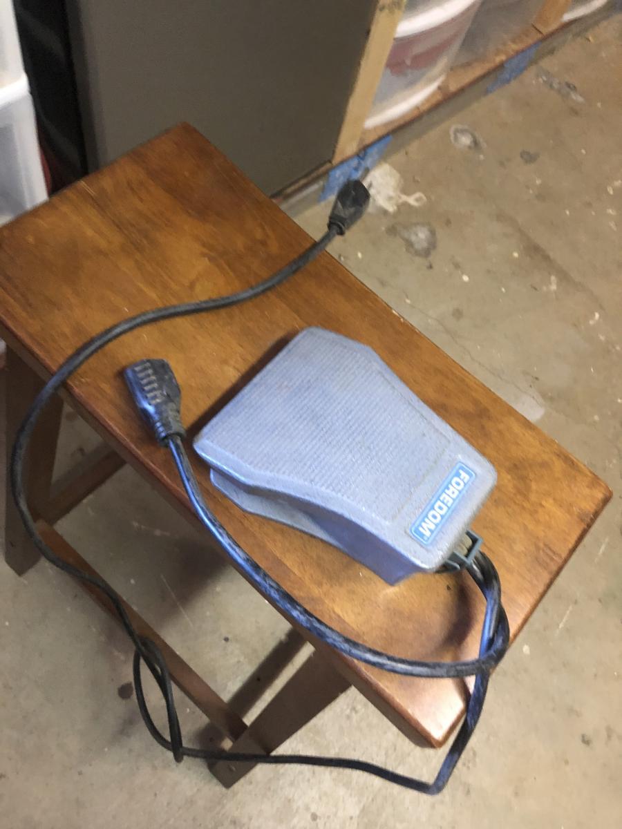

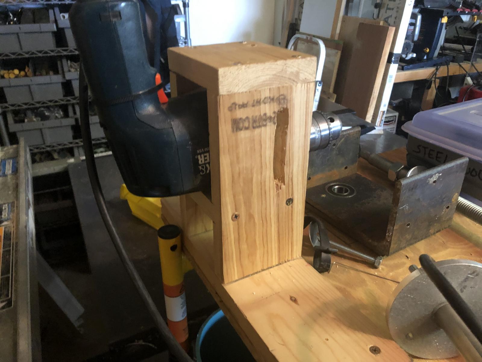

          I have a couple of these foot pedals that I picked up at a yard sale years and years ago. I use one on MY coil winding setup. It allows you to keep BOTH hands free while controlling power to your drill, or an AC motor coupled to your shaft by pressing on it with your foot. You have to get the hang of it at first, but it doesn’t take long. I built a wooden box for my drill that it sets in so I don’t have to hold it, and then plug it into this. I put a zip tie around the trigger on my drill so it is always fully depressed and control the speed of the drill with the foot pedal. I’m incredibly interested in your progress on this as I understand what you are looking for and agree. Going to do something similar on a smaller scale with 6” pvc pipe. Pipe is already cut and Bob is already winding his. I will start winding mine tomorrow. Anyway, can throw this in the mail next time I go to town if you’re interested. Shipping is on me. My contribution to the effort. Click image for larger version

            Thanks, I appreciate the offer but I’m going to try the hula hoop method. Either I print or find flexible pipe at the hardware store

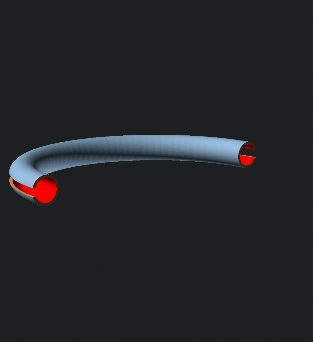

                Hoola Hoop - scaleable to any size. This one is 18" diameter, 5 mm wall thickness, ID = 1"
                For this size will be printed in two pieces and uses a slotted glue collar just like you would pvc.

                      Better idea.... going to make it a rectangle slot like 1” dia 2” deep. Overlapped sections with pins and no collar needed. Can take apart one at a time and tape coil together if desired after winding.

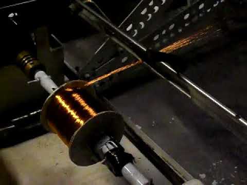

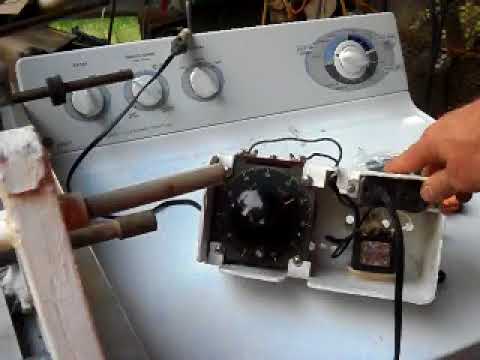

                        I am not a very good teacher in this video. The video shows my multifilar winding machine. It uses a gearbox and motor that would break wires unless I made this control. All it does is puts a mini-variac and another inductor all in series with the motor. This lets me set the breaking point without burning out motors.
                        Sorry about the dark video but it get light half way thru. I can wind at any safe speed and it can be stopped by laying my hand on it. This is my means of setting the tension and not break windings. I tried it without the control and it was impossible to slow down or stop in time.

                          This video is far shorter, plenty of light and shows how well the limiter works. 8min video. You can put this on a drill winder because a drill has a gearbox
