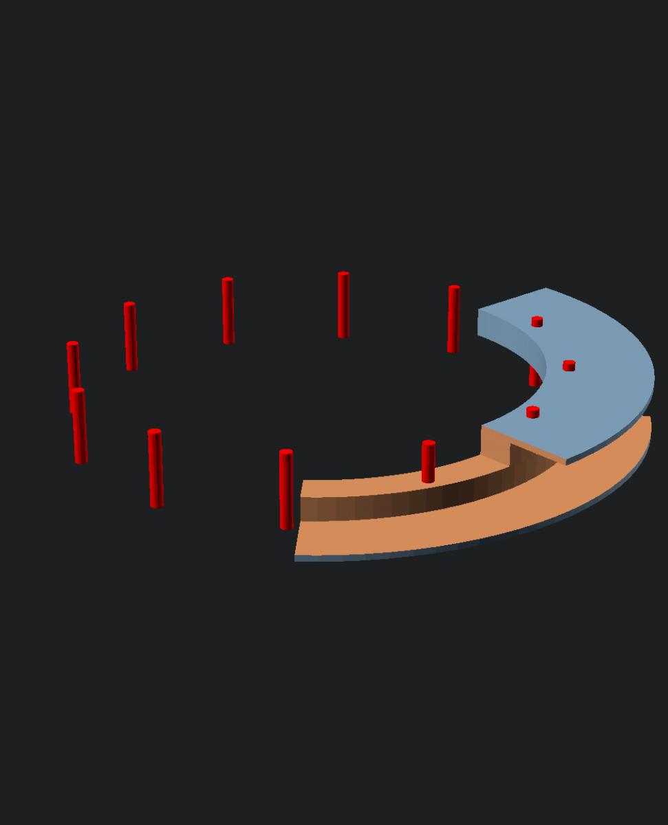

              There are 8 identical pieces. 4 on top and 4 on bottom. The seams overlap and so the whole thing is bolted together with M10 bolts.
              This particular one ( changeable ) is 18" diameter, 1.5" wide channel, 2" deep channel, plus the 1" inner boundary for the bolts.

                OK, that makes sense to me. I wasn't thrilled when I thought the wire was going to be in a tube because you would play hel! trying to get winds side by side in a tube. But now that I see it is going to be a flat channel, it makes sense. Around 7" for each piece? I'm wondering if I could print it on. my small printer or whether I would have to get the bigger one set up and running. Or maybe I should take. y OWN advice and do it with a bicycle wheel. I already have the strips of plastic cut to fit fro. before, so just a matter of finding the time to wind.
                • #23
                  You are correct! I had the same realization. It would be hell and a mess in a tube and hard to print as well.
