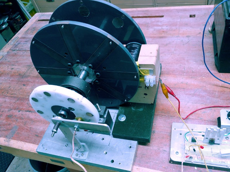

            Hi Guys,
            Here is the next version of Matt's motor with two coils running on about 4 1/2 watts.
            Ron

                    Confession time, I have been deceiving myself and you all with too many assumptions. I finally got around to measure the amp draw for the DC DC converter and was shocked. It was drawing over 3 amps! (bread board electronics 15 mA)
                    So I had been measuring just the out put of the converter thinking it was around 90% efficient --- not so. Mind you I had blown up one 60 volt converter by running it at 63 volts and this one ran so hot I couldn't hold my finger on it, it was so hot.
                    So back to square one and willing to sacrifice my better DMM I get, without Matt's circuit a draw of 2.65 amps at 11.9 volts. (just a diode to short the back spike) 31.5 watts
                    With Matt's circuit a draw of 2.5 amps at 11.9 volts, 29.75 watts
                    Sorry and sad
                    Ron

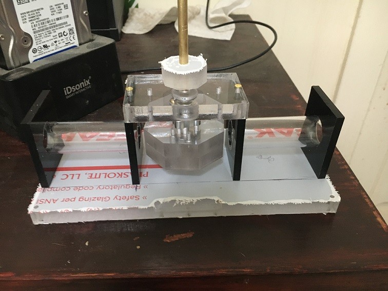

                      I had some problems with the CNC had to get them before I cut up to much plastic but finally got everything done. Few little adjustments need to be made But tomorrow I will get the cores together and maybe wind the coils as well mounting the magnets.
                      Click image for larger version  Name:	TS_Motor.JPG Views:	0 Size:	108.3 KB ID:	511789
                      I also got the circuit designed to run the thing. I am waiting on parts so I can mock it up a bit and make sure I am thinking right. Then I'll order boards. 10 days or something. Initially I am going to test it for while, look for my losses and try to find a way to compensate the system. I built platform so that can receive 2 extra coils. Hopefully I can calculate all the losses and supplement back to system with one coil and do bit of work with other. Just process you have to go through. I am going to post it all good or bad.

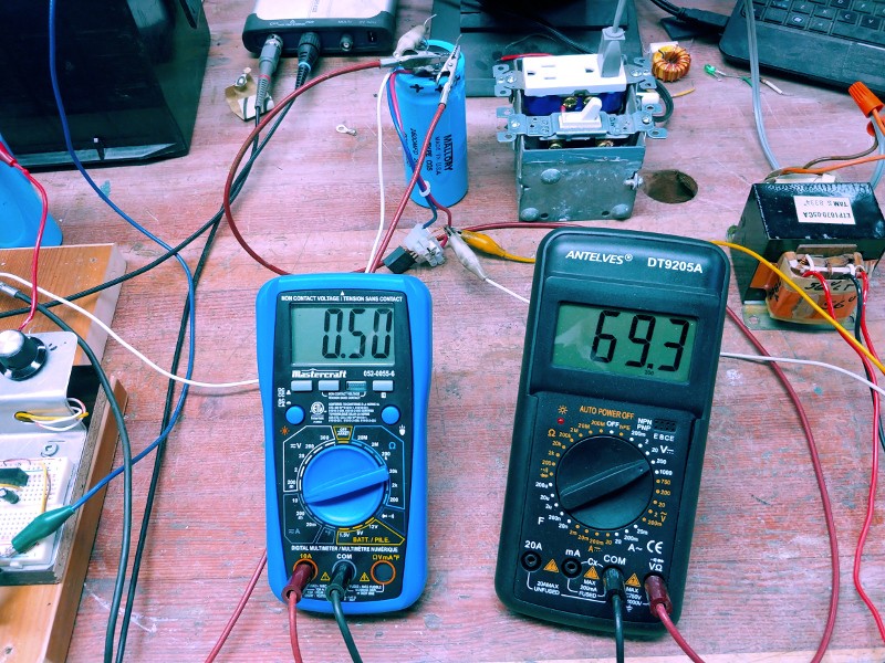

                        Hi Guys,
                        While Matt's scheme is not as productive as I had hoped it is not as bad as I thought either.
                        I put together a birds nest bench supply and the results are:
                        Conventional diode over the coils --- 42 watts draw
                        Matt's scheme --- 35 watts draw, not that shabby.
                        Nice to see my Mastercraft DDM has been idiot proofed to a certain extent for people like me. It has a shutter on the 10 amp setting that only opens when on the 10 amp scale. Once open one can plug in the lead. To turn the meter off one has to disconnect the lead, saves a lot of embarrassment in trying to measure volts on the amp scale.
                        Ron

                              • #30
                                Thanks Matt,
                                I have an arm that lets me adjust the hall timing.
                                This is an early photo I thought I had posted but I guess not as it is just the low side switch showing.
                                And the coils are # 24 wire at 23 ohms so close to 1K feet. So I am coming close to your recommendations already.
                                Some good information from several sources so will continue to try different things.
