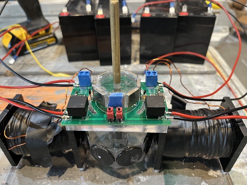

                      SO I have tried to start it up 2 times now the first time the fet's blew instantly. The second run that I tried this morning actually ran about minute. The TVS diodes I put in went first then the fets, but it ran a minute so got a little thrill from it. Apparently the TVS diodes cannot handle the spiking they are very tiny. I am going to beef the board up and get a little bigger parts for it.
                      I'll review everything once I get a running version as well as do some tests.
                      See ya soon.
                      Matt

                          Na.... That's going a little overboard... I didn't spend but 22 Dollars on the boards and everything else I had. I just have to add a better collection snubber across the coils to reduce the ringing. You have to use a double mosfets for the serial switch and I am sure not going to buy 4 $33 dollar gan fets to do the job. They also have a High RDS on compared to what I am using.
                          Matt

                              Ya I have looked at those The biggest problem I was having is the voltage of the Mosfets in serial position was too low. The ringing from the coils is pretty high so a good old resistive snubber does the trick. I was trying parts that I had in my inventory but I ended up beefing everything up above what I should need then I'll scale it back down later to keep it cheaper and more efficient.
                              I should have everything back together this week. I haven't given it my full attention cause this year the heat is coming and I want to grow a good number crops. Wednesday and Thursday I think are going to be in the eighties and this is February. So I have really stay on the ball to make sure everything is going to produce. Its flippin me out a bit.
                              Anyway fully measured results coming soon.
                              Matt
