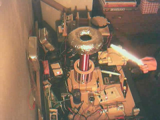

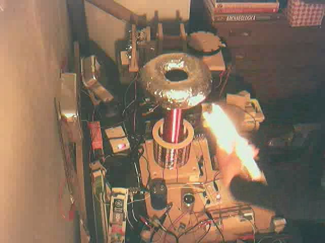

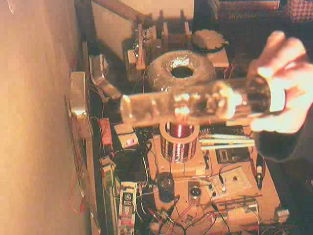

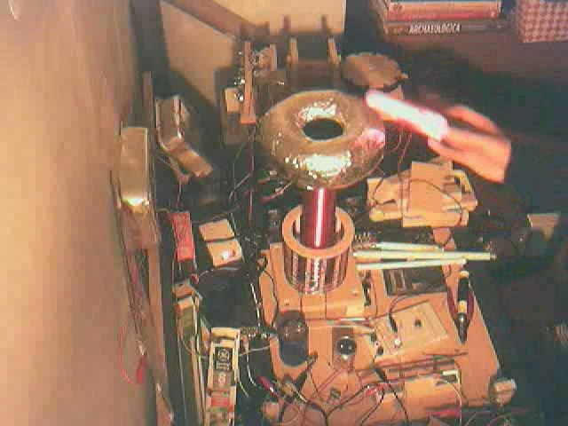

I nearly dropped it in shock as the entire tube lit to orange and red.
I have to turn the (simple SEC in this case) circuit off and back on to get it back to normal. And sometimes even then it goes straight back into the minus.
The LED across the emitter and base flashes briefly when I turn the circuit on and off, but it remains off when the power is left on and the circuit is drawing 280-300mA, and the transistor (BC182) gets hot. I'm using the same 6kV trigger transformer as before, a tiny toroid out of a CFL with 5 turns of 0.2mm stranded wire, and all the same materials (IE trays) that worked with the simple SEC circuit.
