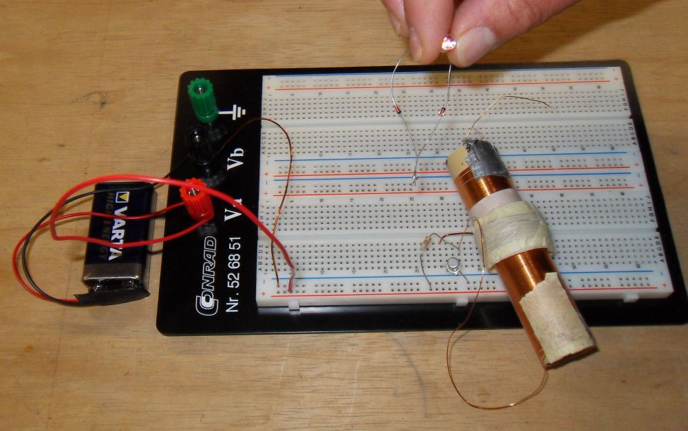

Sorry for being a bit sloppy about the technical details in my replication
used what I had at hand:
- inner coil to be shifted, 200 turns of diam 0.31 mm (28 AWG) magnet wire
- outer coil wound in opposite sense ca. 12 turns of diam 0.6 mm (22 AWG) magnet wire
- used a 4.7 k resistor after the transistor got really hot with the 1k but honestly have no idea if that is the right solution.
No tricky tuning no nothing. Just pug 'n play.

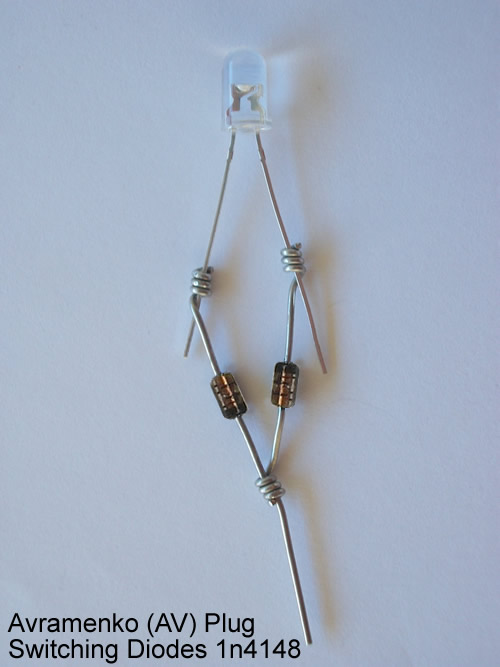

No time for proper testing, yet, but it is the first time I can hold a LED at its plastic head and it will light full brightness, wirelessly. With my own "vortex trafo exciter" I always have to touch the wires of the AV-plugs or ground the AV-plugs.
Thanks also to the doc for starting this whole affair and to all the collaborators in the old and new threads.

but the output was like a SEC15-3. I ran it on 5.5 volts. The little 2n2222 survived and I will do more testing today.
