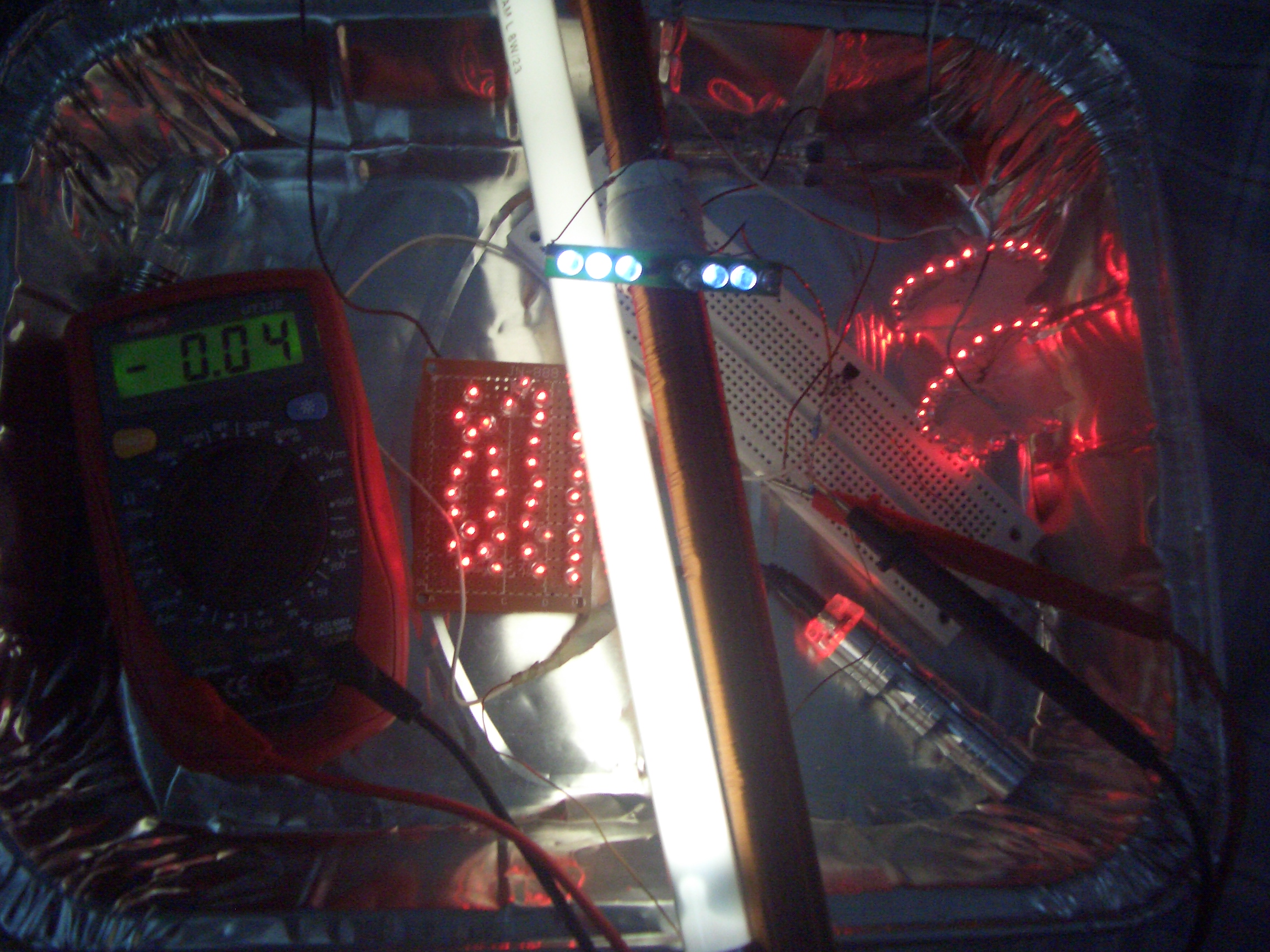

    • GBluer Grounded Exciter Circuit
      This is an update on my post 263
      Remove the ferrite rod since it only absorb the energy from the coil when fine tuning the fluoro tube must be near the rod to light up bright ly
      Tested with welding rod energy again absorbed
      Used only L1 and L2
      L1 coils touching both sides of the aluminum pan
      one 8 W lamp bightly lit up beside L1
      3 sets of LEDs
      1 Led (6 in series)) on top of L1
      7 LEDs in seies ( each 6 in parallel)
      connected to 4 LEDs in series ( 10 each in parallel) and not touching L1
      The LEDs and cellphone charger are placed inside the pan
      Current draw .05 Amperes with recharged(1 hour) Alkaline battery.
      Hope this help
      • Grounded Gbluer Exciter Circuit
        Attached is the picture of my set up from my post 263 and 272
