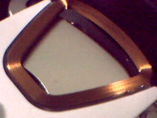

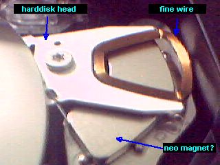

                  Sorry if this is off topic
                  Just opening some harddisk and find the coil position over magnet is rather interesting.
                  Is the very fine wire the key for harddisk head controller precision? I still don't get how it the controller move over the flat neo magnet. Very wide coil almost covering north to south?
                  The harddisk controller should consume very small power considering it's wire size? But it can move very fast during operation.

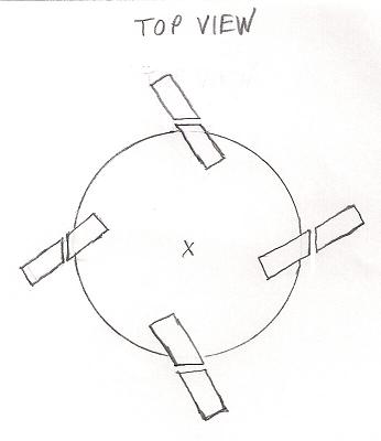

                        Hi Luc,
                        I have attached a drawing how I thought to fix the cores at an angle wrt the radial direction on a rotor disk, unfortunately this would involve cutting the cores' facing ends at a certain angle too, they could not be with 90 degrees corners. I think the most repel force can be received only this way between a rotor and a stator where the facing areas are flat and not with any arc.
                        Obviously this setup surely will works if cores are not cut at an angle but left with 90 degree corners but I think useful torque will be lost in the wanted direction of rotation because in this case most of the repel forces will go towards the radial direction. Also when the corners are left in normal 90 degree shape, the facing areas between rotor and stator cores reduce as the rotor turning advances, hence useful repel forces get reduced even rapidly, wrt the slanted cut core ends.
                        Of course there is relationship between the thickness of the core and angle of the cut, so that the very edges of both the slanted cut rotor and stator cores should not touch each other when rotating; this involves keeping a certain distance (an air gap) between the rotor and stator core, and unfortunately the higher this gap the more repel force is lost.
                        Re on your 'current will not go up' question: you can test this by your hands, moving one of the cores (in repel mode) towards the other and at a very near facing position suddenly reduce the moving speed (imitate a cogging situation) and watch the current meter. I do hope you will not notice any current change (after your test yesterday). Remember this is intended to be a switched (i.e. a pulsed) motor and I think the switch(es) should only be ON from just after the facing position for a small time duration to establish the repel kick-out force, then OFF again.
                        Maybe I do not interpret correctly the DC setup drawing of DMPOWER, but that is how I would think it works. Nevertheless, I cannot see any back induction possibility when the rotor suddenly slows down due to a increased load because this should have already manifested in your yesterday test.
                        Re on your repel and attract mode question: if you mean that in repel mode you are able to keep the two cores pressed totally together with one hand easily, (using the same current as in the attract case mode), well this is interesting to say the least... I mean I would not have thought for as a big difference between a repel and attract force of two identical electromagnets as you have found.
                        Maybe this could be utilized by making a DC polarity change switch for the series coils: when on approch they receive an attract polarity current and after TDC they get a repel polarity current, this is what suddenly I can think of as a 'remedy'...
                        On your latest video: maybe fixing springs at the endings of the steel rod to conserve most of the bumping energy that otherwise would dissipate would also increase your efficiency, besides using bearings. Very good test!!
                        rgds, Gyula

                                Hi Gyula,
                                thanks for the illustration ... very easy to understand now
                                I do trust from my repel tests that this kind of setup will not cause generator effect (BEMF) but I do not agree that it will not increase in current draw when under load.
                                The coils will be turned on and off at the ideal timing setting found, right?
                                This on off timing period will changes with motor RPM (longer at start up and shorter at full speed) right?
                                So if the length of the on off timing periods change with RPM then when it is under load and RPM reduces and coil on off time increases would you not think the current will increase?
                                I will make a video to show you the difference between repel mode and attraction mode using the same power input and you can make a decision.
