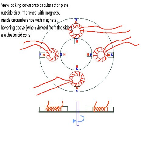

  • GOTO,
    please use THIS attatchment rather than the previous one..
    thanks,

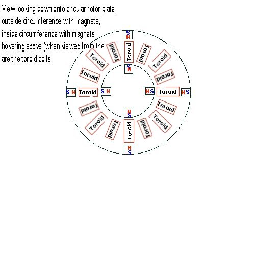

    • @rave
      If you have the toroids as in the first pic, you can pack them really tight around the motor (tighter than in mod pic below).
      /Hob
      Hob Nilre
      • NIL,
        that works too
        i was just trying to keep simple and keep construction costs & time......down.

          • GOTO,
            the toroid cores are ferrite, no details as im aware as to what exact permiability, windings that steorn and other rep's are using seem to be around 0.5mm - 0.55 (around that)
            the only "fuzzy" area is matching the strength of magnets to the toroid coil... too strong of a magnet = lots of torque in attraction to the ferrite but the toroid will not be able to cancel/sheild all of the ferrite from such a string neo-field.
            most people seem to be using around 20-25-30mm diameter cores.
            the overall circuit is basically a bedini trigger.... can use a seperate trigger coil placed around one of the toroids to trigger a transistor....or a reed-switch...or hall-effect.
            on his site ( link at bottom ) naudin, as well as actually replicating the steorn motor, has done a simple little test with a ferrite toroid coil.with a magnet hanging off it below it..giving the coil a quick pulse.sure enough the magnet drops off.
            The exciting part is the dual or even tri or quad use of just one toroid being used to cancel the attraction of say 3 or even 4 seperate magnets of 3 or 4 rotors, all with a single pulse, which is where i was heading with my image diagram.
