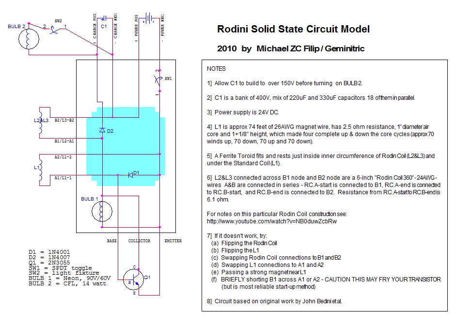

    This Experiment involves using a Rodin Coil within Bedini SSG circuit and resulting in a solid-state resonant oscillator with notable high-voltage and high-speed charging and even current-driving abilities off the charging lines (I light a 14W CFL off of the lines going to charge the caps). Because of the combination of Bedini and Rodin, I have nicknamed it 'Rodini'.
    I am no expert, but the Rodin Coil's magnetic vortex is highly influencial here in its action upon the normally-wound trigger-coil. Most of the active field is contained with the inner circumference of the Rodin Coil, and the alignment of the normal trigger-coil with the Rodin Coil's field is critical to get any resonance and high-voltage.
    A video of the Solid State Rodini can be found here :
    YouTube - Rodini Solid State - bedini rodin coil combo
    Included is a diagram and description of the setup for those wishing to replicate, it is the most current version (more current than the video), the difference being better wound trigger coil and use of 2N3055.
    From a 24VDC power supply I currently have it so that the caps will maintain a charge around 120V while also lighting a 14W CFL to what appears to be full brightness. Play with the relative positioning of the coils to find the best spot - the neon brightness will increase/decrease as an indicator, and when you've found a good spot you'll see the capacitor charge rate increase and the maximum charge voltage level increase. Moving the trigger coil too far from the active field in the Rodin Coil inner circumference will cause a loss of resonance / failure to resonant.

        quicky update, just got to finish winding another torus coil and re-arrange my 494 circuit, then ill be almost done for repping your circuit, btw..what frequency / duty cycle did you use?
        David. D
          power supply and operating frequency
          Hey David, thanks for the quick work on the replication, I hope it works for you and perhaps you can get some better measurements :-) My lack of oscilloscope makes answering your question (and some of my own) difficult.
          The power supply is coming from two ATX DC Switching Supply boxes (yoinked from old computers), each feeding off the 12VDC lines and connected in series to my circuit. As far as I can tell, it is constant DC, but I cannot be certain. I intend to use two 12V batteries to compare, but at the moment only have one.
          When the oscillator is on, I've compared the sound of the coil hum to that of a computer signal generator and at around 2.9-3.1kHz they sound the same. To me, so grain-of-salt that. When it sounds like this, I get the best charge rate and level. I can change the pitch (frequency) easily by moving L1 around relative to the Rodin Coil. Many position tests led me to leave where it is at the moment (making this pitch of sound) which is slightly off-center. Your configuration may have its own sweet spot.
          Something to note, the capacitor bank I'm using has been used in MANY experiments and is most definitely what they call 'conditioned' - this may have an impact on the efficiency of the circuit. Hopefully you also have well conditioned caps to test with ;-)
          -michael

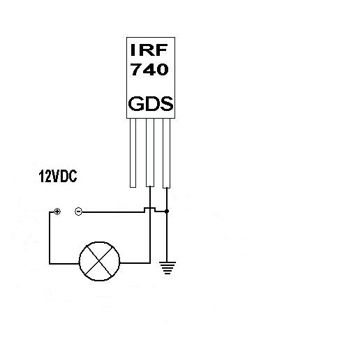

            Hi all,
            just a quicky, looking at the attached simple circuit....my bulb is light...this shouldnt be the case surely?? i thought an n-channel mosfet only conducted from drain to source when the gate is "high" ?
            help.....im puzzled and my pwn circuits are no longer working !!....
            p.s i should mention i have tested about 3 brand new mosfets now and the bulb light permanently.
            David. D
              folks, i figured it out ( eventually )
              im not going to tell you what was wrong..because its too emabressing !
              enough said
                Hi Rave154,
                I am kinda new at this... The attached Image would be the correct way???
                  thanks stubbs,
                  you are correct
                  my mistake was.that i had the polairty of the battery on the "actual" circuit.backwards
                  didnt realise till about 3 hours was wasted
                    GEM,
                    im just as i speak, in the process of putting your circuit together, i got way-layed via problems with my pwm circuits etc..all sorted now :-)
                    as im going through your video and circuit...and hopefully you still have it arranged as it is in the video...could you try 3 simple tests just for
                    "sh*ts & giggles" as they say...
                    the coil of white cable that is the cord for the CFL lamp...
                    1) could you take that coiled up cable.and as the circuit is running...remove the standard coil..and replace it with the coiled up cable...
                    2) as another test...replace the standard coil as normal...and place the coiled cfl cable loosely around the standard coil...
                    3) loosely wrap the cfl cable around the rodin coil itself , as in, wrapped around the equator or circumference of the rodin.....not wrapped toroidely.
