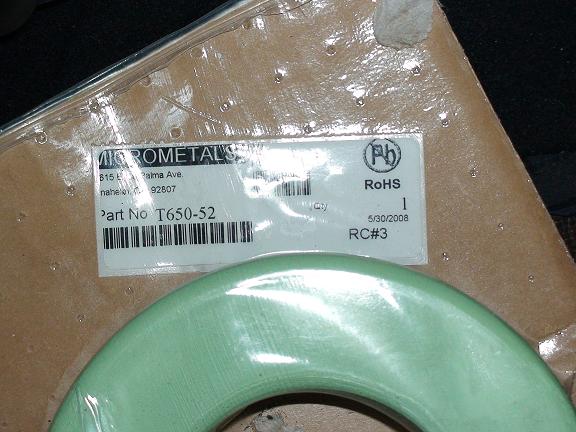

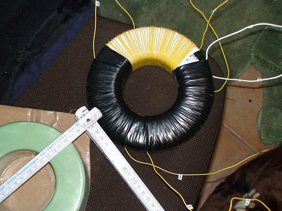

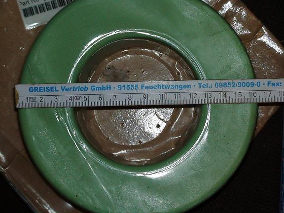

        Hi Geminitric,
        Would the attached be worth a Rodini wrap?
        They can be found w/specs @ Micrometals, Inc. - Power Cores
        The third pic #xxx15 is part of a unfinished B. Boyce project
        • #19
          stubbs, thoise look like they would be ok to wind a rodin around

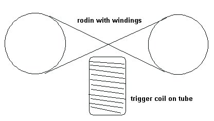

                            here is a quick diagram to illustrate the position of the sweet spot, of course, depending on how your wired you may need to have the rodin above the trigger....or below it.
                            raising the rodin higher than shown in the diagram reduces the amp draw, but also reduces the voltage on the cap

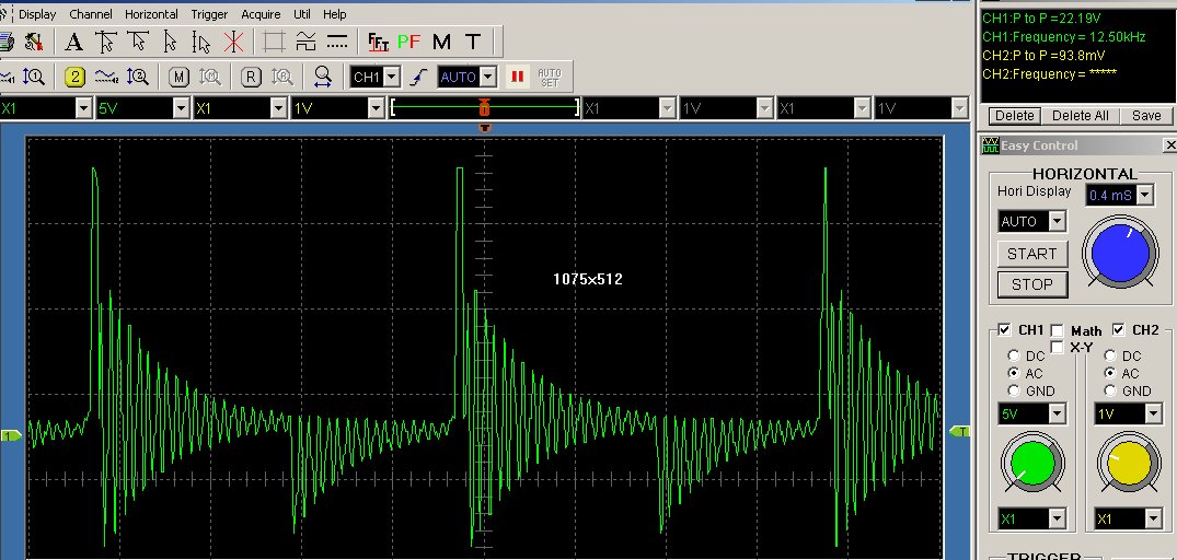

                            • #29
                              scope shot using coil from a shaded pole mtor (300ohms) in porximity to rodin coil , about 1 & 1/2 inchs above rodin coil

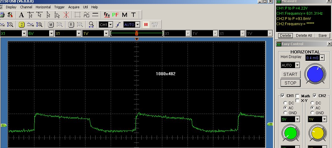

                              • #30
                                scope shot directly across the trigger coil
