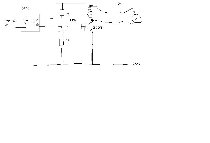

    in order to be able to drive bigger loads ( voltage/current )...you coul wire up your wave generator as in the attached image...which is what im using to allow me to use the PIC which can only supply mA....but can turn on/off the transistor in order to use much bigger currents etc..
    simply replace the two connections where it says "from PIC"....and connect your wave gen there ( observing correct orientation on the diode that is in the opto-coupler )

    • YES!!! thank you rave and jbig!! .. I knew I found the right forum..
