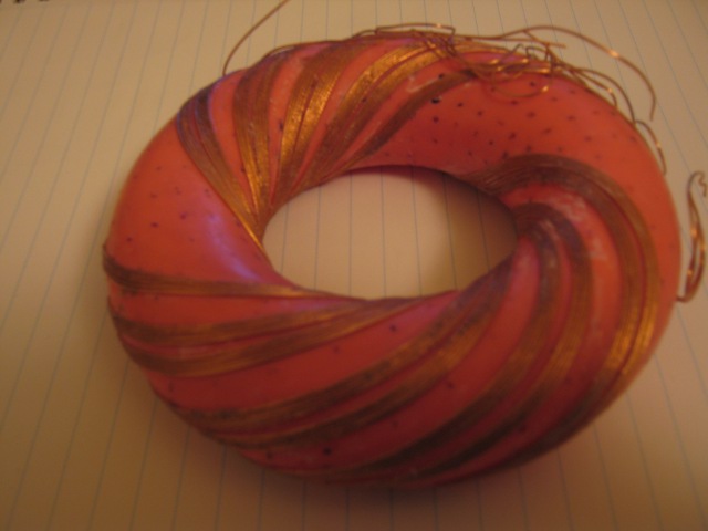

                              • almost there
                                hi all,
                                9 out of 12 windings completed...had to stop cos my eyelids are starting to stick together from the super glue fumes
