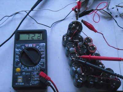

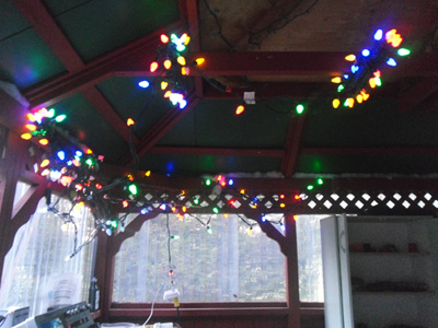

                        Finally! Got some new equipment. Got a space set up for experiments. What I don't have much of is time... grrr!!
                        But, I've dug everything out and put it back and got up to where I last was, with better equipment this time. I've attached some shots of the current setup... uploading a youtube vid, but these shots cover whats in it. nothing much new in the circuit - trying out a FWBR on charge... tests will show difference. For now, it seems to 'work'.

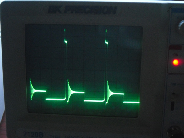

                        I've attached a pic of the oscilloscope shot with the probe connected on collector and grounded on emitter.

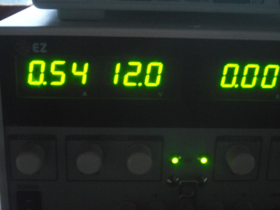

                        right now it is running off 12 V, 0.54 A. The capacitor bank is standing at around 72V, while lighting up many strands of LED christmas lights. It works off a 9-volt battery, just a bit dimmer, but fun to see it off the grid.
                        So, the oscilloscope is set at 0.1 mS/div, 5.0 V/div. The signal repeats 3 times across the 10 divisions of the screen. I'm going to sit and figure out the calculations for what is going on here... it's nice to be back in the game.
