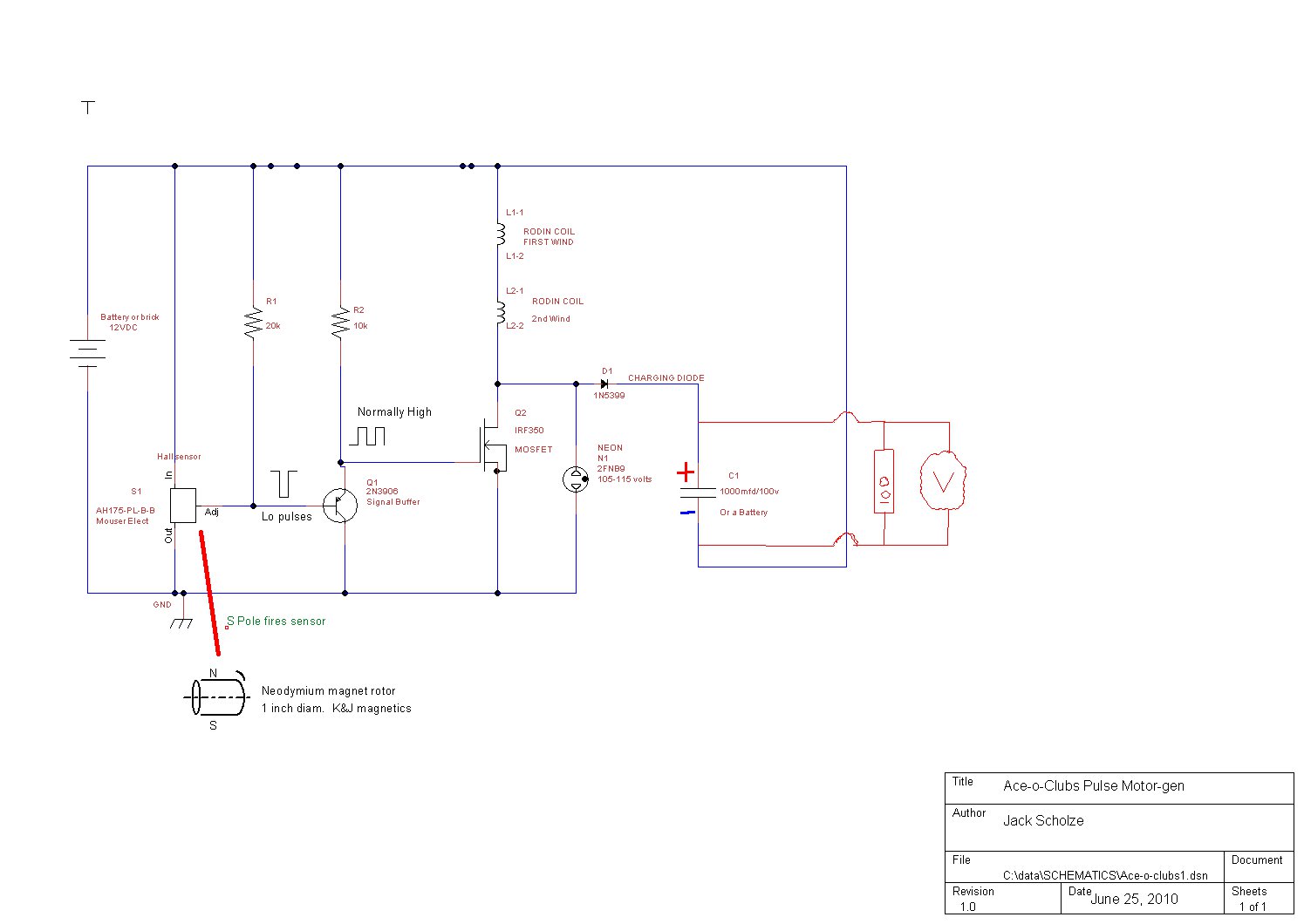

      • Jimboot,
        nice neat looking coil..though i think perhaps you may need more wraps than you have...but, only a test will show.
        As for schematics, you can do as geminitric did, and have a standard bedini circuit but with the two rodin coils in series with the bedini drive winding.
        Or 1 rodin winding in series with the bedini and the other rodin winding as a generator.
        on both of the above you would have the rodin coil sort of sat on top of the bedini coil..with whatever rotor youre using in the middle.
        Or you can do something like Jack Schulze from you tube did,
        i have attatched his schematic the he uses.
