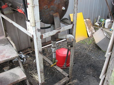

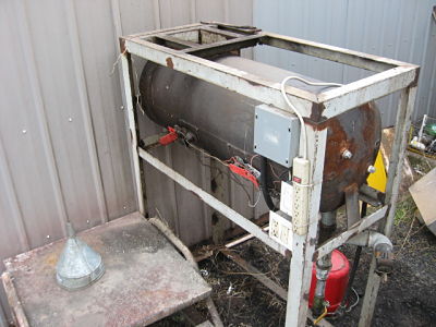

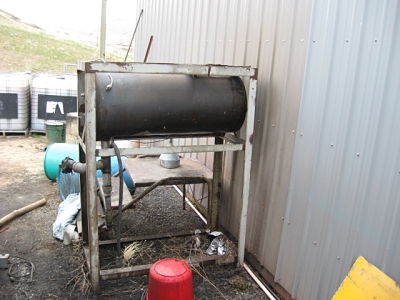

                  This is a pic of the bio-diesel oil heating tank set up I built from a discarded electric hot water heating tank. Two additional heating elements were added and welded in and 2 separate 110Vac light switches to turn off or on both sets of elements separately.
                  I cut two elements from another discarded electric water heater around the mounting area in a square pattern allowing about 1 inch from element mounting holes. Then cut holes next to existing elements in tank and welded them in. Elements were orientated so they are going into tank and staying on a horizontal plane. Reason for this is if they pointed down they might come into contact with water and oil at same time and burn them out prematurely, if pointing up they might extend above oil line and burn them out. Elements must always be submerged while on or they will instantly get too hot and have a melt down. This can also create a fire if unattended, so I chose to simply mount the tank inside of the angle iron frame with elements positioned directly on one side going straight into the tank....this also makes it easy to pull them out if they burn up. Expect to pay between 9-20 dollars per element if they burn out. My elements have a high amperage and wattage rating as I wanted to heat the oil as fast as possible. This unit runs at 5,000 watts on two elements or 10,000 watts on 4. I use a 50 amp breaker in the electrical panel for this circuit. Do not run anything else (at the same time) that uses 220VAC off this circuit unless you want to throw the breaker. You will notice in the pic an outlet is also wired beside one wall switch so I can plug in my two mixer motors of 1/2 hp each. I have run this and two mixers with no problems and have processed 1000's of gallons of bio-diesel with this simple heater.

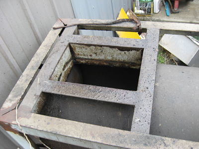

                  Top of the tank is equipped with an opening so oil can be poured in from jugs or pumped in to fill tank. The metal flanges extend into the tank and are welded to the tank on all sides to prevent leakage of oil, all seams are welded also. I just cut 4 plates of steel from 16 gauge sheet metal from a old appliance or car body flat panel like hood or top or deck lid. The angle Iron was from a cattle gaurd side rails that were discarded. They are 1-1/2" x 1-1/2" x 3/16" wall thickness angle irons.
                  The tank at the front had a two inch bung welded at the bottom for water trap and exit port fitted with a molassis valve for quick filling of a 30 gallon plastic drum with top cut out leaving at least a one inch lip for mixer to sit on. Chose used plastic drums with the flattest tops as they work best. I cut the tops out of ten drums for my process. I get all the drums I want for free at local farm co-op that were used and had glysophate herbicide in them. The chemical is water soluable and is easy to rinse out. The stuff is toxic so wear good protection and dump out where you need weeds killed or save solution for a sprayer, most the time they have already been rinsed before you get them. I cut the tops out using a 1/4" angle die grinder with the thinnest 3" ceramic cutting disk. Will post a pic of a cut drum in a later post.

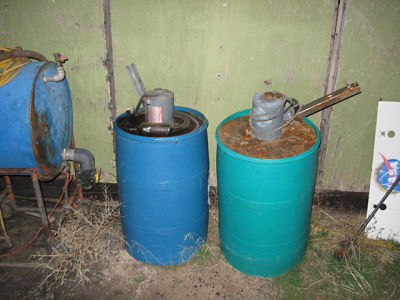

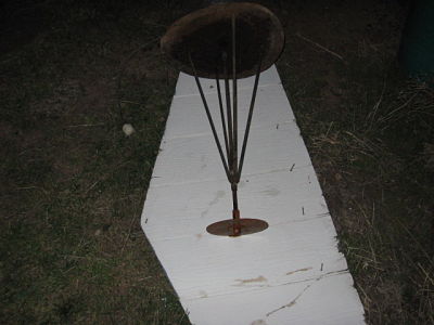

                        Here is some pics of my home made mixer heads made from farm grade fans and motors I bought at a garage sale for 20 bucks each. I removed the fan blades and shroud to have just the 1/2" shaft extended and then cut a round piece of heavier gauge sheet metal that just fit inside the lip of the 30 gallon drum top and then could sit on the 1" lip you leave when cutting the top out. The motor was then mounted to the large disk, motors had holes already tapped around shaft so it could be mounted to the flat large disk. I will post more details of the mixer if people want it. It should be pretty apparent by the pics how you might build it. I used rebar for the steel pyramid shaped shaft support system.
                        More Oil Heater tank pics also

                          Additional note:
                          Use only a sealed type explotion proof motors for mixers as your going to be mixing Methyl-hydroxide into hot oil, the fumes of which are highly explosive. Use in well vetilated areas preferably outdoors. Even with these units i have on a couple of occassions had a minor egnition explosion which raised the mixer off the barrel slightly when it poofed, luckley I started the mixer fast after adding the alcohol/hyroxy mix to the hot oil so not much fumes had built up, or could of been a little more dramatic. I isolated the problem to some lose wires on the power cord to the motor that were arching slightly when I started the motor. When I fixed the problem it never happened again.
