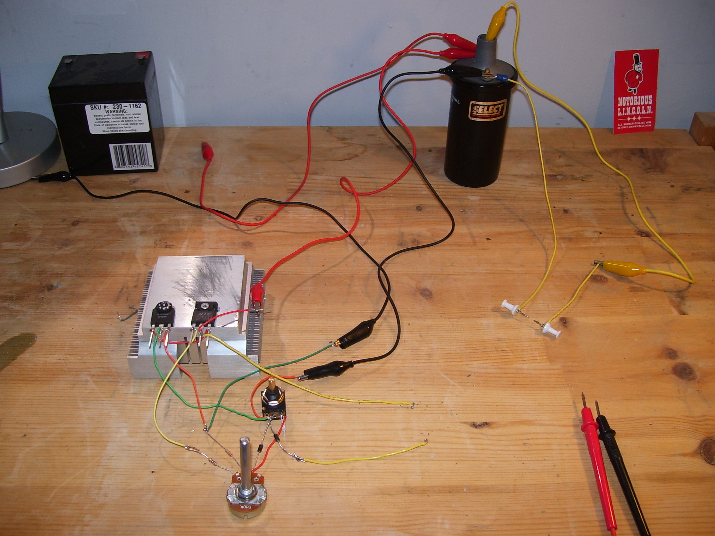

                            • Ok, I'm almost done with my stingo replication. It's not yet working, and there are a few things I don't understand.
                              I believe the car coil primary is connected to the + and - terminals, and the secondary is connected to the center and - terminals. Is that correct?
                              In the circuit diagram, it looks like the spark gap is coming off the coil secondary. However there appears to be another gap connected to + and a diode. What is this?
                              • Originally posted by fzzzy View Post
                                Mine common primary and secondary terminal is marked (-), but there are people who has the common terminal marked (+).
                                Maybe you can notice by seeing which terminal produce bigger spark.
                                Battery charger. You can use it to charge another battery without much heat.
                                BTW, you mount both transistor into a single heatsink. Are you sure they didn't short together?
