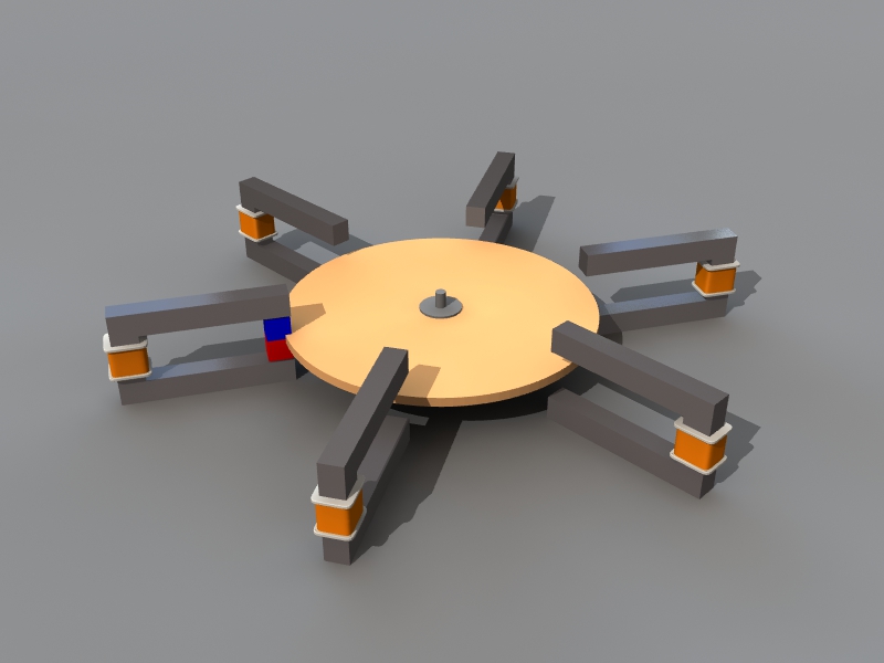

        @LtBolo: I suggest you keep on experimenting and fiddling since you already got this far. But ultimately I would suggest to work with a PM and exploit core saturation. Changing induction by movement of a core is bound to create a change of flux which will lower current first and then recharge your coil again, but the latter will take long due to the increased inductance so you end up with no gain when you discharge it.
