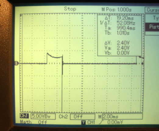

          after another 2 hours of P. L. video, i try to make me an image of what is the BEMF on the pulse motor.
          So to say , as the braking on the shaft seems to be not so negativ on the current draw, in comparison with conventional electric motor, i am thinking that the generative power is not so disturbing.
          i mean perhaps this generative power is out of phase in the general action.
          As per P.L. in the conventional motor, so far i understand, all the events are becoming together at the same place at the same moment and on the same component
          That is to say, that the powers going in ,is counteracted by an opposite force ( BEMF) of a very strong magnitude. ( almost 80 %) and this at the same moment.
          So the efficiency is very poor in comparison with a no BEMF motor as an attraction motor without the mixture of magnet and coil. That is to say with no BEMF. but of course also , with not the profitable power of the magnet.
          I will try to replace the magnets with pure iron bolts on this test proto to see if i can get better results (YouTube - ‪motor with kickback spike-generator.wmv‬‎
          So i enclose here 2 scope shot
          the first is the isolated coil in " normal * work, that is to say in serie with her sister and of course in generative mode.
          the second is the same coil but isolated from the system (without the generative action)
          hope this helps
          good night
          Laurent
