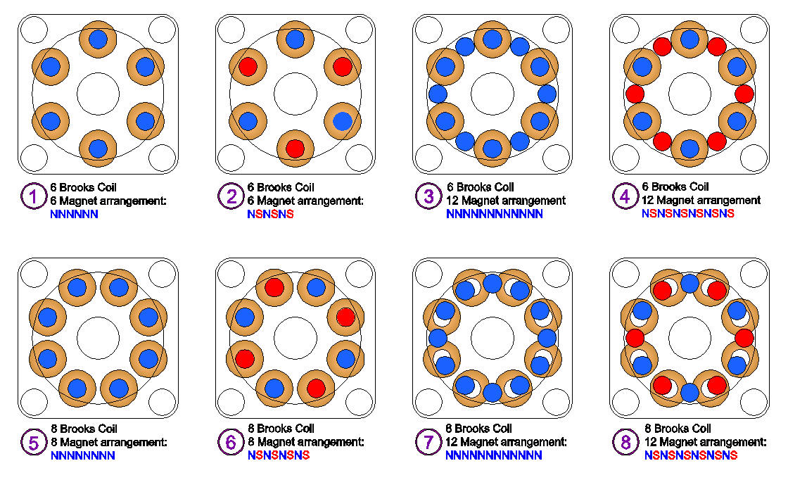

          • #95
            Hi SkyWatcher and all people
            Uses more coils and the magnet, can have a higher efficiency?
            how does the magnet arrange correctly? NNNN arrangement? NSNS arrangement?
            in appendix picture 1-8 which correctness? Which efficiency is highest?
            Xu
            • #96
              Hi folks, I tested the motor in repulsion mode and the torque was the same and the flyback recovery was a little better. Without cores, I don't think it's ever going to be as good for flyback capture when using rotating magnets that diminish the pulse input. Though it's meant to be a motor. Hi yx630514, thanks for reply. Yes I probably could put 6 more magnet stacks on each rotor, though they would have to be the alternate polarity. It may help performance, though not sure if efficiency would go up. I would still only use unidirectional pulses though. And I would try this if I had more magnets. Hi Turion, look forward to motor progress and nice idea for removable coils.
              peace love light
              Tyson
              edit: yx630514, number 4 in your picture would be the one id try.

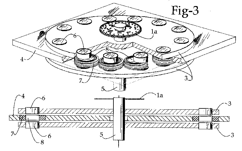

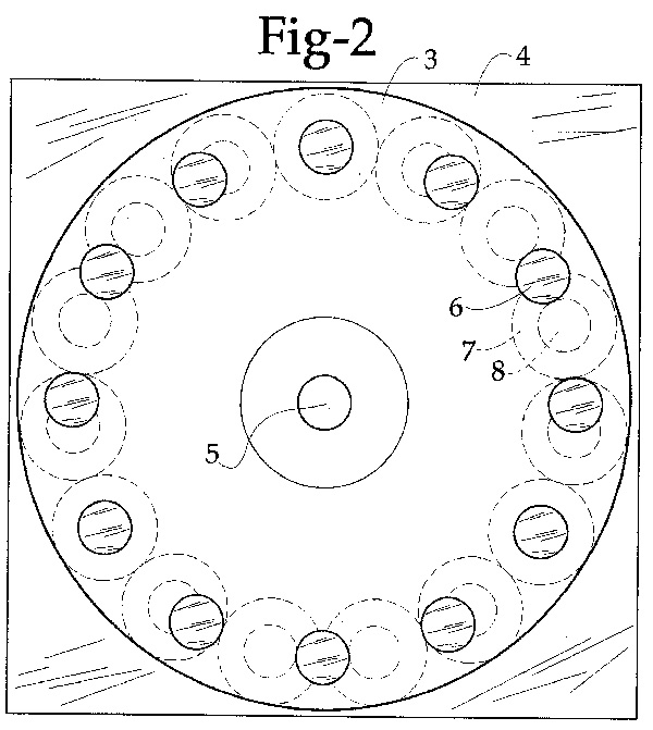

              • #97
                Patent number: US005514923A
                Hi: All people
                [High efficiency DC motor with generator and flywheel characteristics]
                United States Patent: 5514923
                This patent should everybody know
                This equipment uses 15 air core coils and distinguishes 12 magnets up and down? Why is such quantity coil and the magnet? What truth has? Its magnet polarity arrangement way is what kind of?
                Xu
                • #98
                  Hi yx630514, that patent motor is good also, however much more complicated switching. There are other variations which would be good and only require three sensing/timing switches and no complicated electronic controller to break down.
