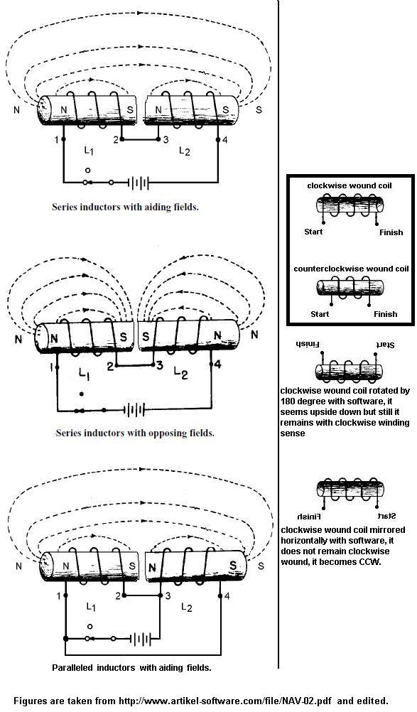

                              • Originally posted by garrys View Post
                                Hi gyula, your pics are ok and i know its hard so try drawing it this way ...your second one shows 2 horrizontal coils, you effectively have them shown as a group of connected m's eg mmmmm so if you turn them around you still get mmmmm but in reality if you turn them around you get wwwww can you see the subtle difference here if you look at a c from the front and then turn it around it becomed a D without the verticle line of course ...can you not see from this that turning half the coil or one of the pairs does in fact change the direction it the windings ? the direction of the winding is totaly relative to your point of view ?
                                Hi Garry,
                                Ok, I understand the mmmm and wwww examples, however these do not really turn like that in practice: just hold a few turn cylindrical coil with its centerline axis horizontally in your hand, observe its widing sense at ,say, on its left hand side and then slowly turn it horizontally 180 degree, and then check the winding sense at its left hand side again (which was of course earlier its right hand side), you would find the same winding sense; this is what I found. You can easily check this with a piece of wire, making a few turns from it onto you fingers.
                                HOWEVER, if you make a drawing in the computer and use its built-in turning and rotating functions, they will change the winding sense!
                                EDIT Just noticed that when I rotate 180 degree the coil symbol with software (I use MS Paint built in the Windows), the winding sense does not change, seems it maybe does but it does not; you can convince yourself on this by turning the Start wire under and behind the core symbol to add half a turn in the black box on the CW wound coil and unwind half a turn at its Finish wire: you get exactly the first rotated coil symbol shown just under the black box.
                                Winding sense changes only if I use the mirror function and the second coil symbol shown under the black box demonstrate this.
                                Sorry for this mistake but now it is clear. I have now written this into my drawing too.
                                I uploaded a drawing again, see these turning and mirror images in the right hand side column, under the black box.
                                I indicated with a start and a stop the windings of the coils and always watch a coil drawing symbol from my start wire: it can go either clockwise or counter clockwise of course as you guide the wire, I show this in the black rectangular box.
                                In the left hand side column, I show your two identical coils first in series with the same winding sense, then the second coil with opposite winding sense, still both in series, and in the third bottom drawing the second coil's endings are replaced to correct for the poles and achive the parallel connection with the first coil. Is this how your coils have been used?
                                [EDIT: just noticed I connected L2 coil's end #4 directly to the battery, it should go directly to L1 coil's start #1 instead, will modify the drawing tomorrow.] NOW I uploaded the correct drawing.
